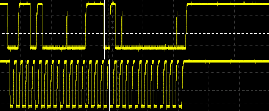

  • I have used an  oscilloscope to get I2C SDA line.
    first I send the commod " tca8418_write_byte(chip,REG_KP_GPIO1,0)"
    and then i can get the  following waveform
    Because my oscilloscope is a single channel,so these two pictures are  syntheticed by me。
    and Can I prove I2C communication is normal throught the pitcure?
    when I read the register  GPIO_DAT_STAT1,I can get the following waveform:
    and you can see that the slave is not respone at once,and these is also no ACK when I send the register addr to slave。All the read  is different form the datasheet about read register like this
    so could you tell me,why there is no ACK when I read the register.thanks.
    From the scope shot of SDA/SCL you've shown, I believe I can make out what is being sent and received:
    First message is 0x34h R/W'=Write ACK
    Second part is 0x1Dh ACK
    Third part is 0x00h ACK then release I2C lines.
    From this, it looks like you are successfully able to write to the register because there is an ACK in all three cases. So I don't understand why in software it tells you there is an error.
    Your second o-scope picture, I can't read the data because the SCL line is not there for reference, I can see that from the old picture ACKs are shown after master released SDA line so there is a small spike. There is only one small spike in the first half of the picture which states the device ACKs for its address but not for the register ID.
    Can we try to confirm read works with a different register like 0x04h or 0x1D after you write to it?
    -Bobby
  • this is the picture,When I read the register GPIO_DAT_STAT1。
    Is there anything unusual here?
  • It looks like in the first half of the picture you are writing to 0x34h write then 0x14h and you get an ACK for both. However your clock signal hangs low instead of releasing the SCL line. This could be a problem for the state machine so it would be best if you did a stop condition and then did a start condition again to continue trying to do a read.
    The Second half of the signal is a bit hard for me to read but looks like you are sending the address again 0x34h with a read bit and then receiving 0xAF (a bit hard for me to read). I do see that on the last clock cycle, it looks like the master is ACKing but then you do a stop condition which could glitch the state machine because it is expected a NACK and a stop condition instead of an ACK and a stop condition. This may be why you are seeing the GPIO_DAT_STAT1 getting stuck. Are you able to send a NACK instead and then try doing a read again after referencing GND/Vcc (reference all the inputs to GND)?

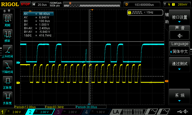

  • Happily,I can finally use the dual channel oscilloscope。And when I read the register GPIO_DAT_STAT1,I can get the picture belowing
    and then,I  divided the entire waveform into three parts,I divided the entire waveform into three parts and magnified them separately for your observation.
    The first half
    the second half
    and the last half
    please tell me,is there any    int these pictures?
    Or I can refer directly to your last reply?
  • I change the gpio level ,and read the register GPIO_DAT_STATx,it is a right value
    The new waveforms are much easier for me to read (thank you). It does indeed look like in the last picture when you read, the value is 0xEFh which suggests you are holding Row 4 pin low. Are you not doing this? The new waveform also looks like you are NACKing after you receive the data which is good.
    In the first waveform after the first ACK, there is a small "glitch" where it looks like the slave who ACKs releases the SDA line and then a small amount of time later the master pulls low. It doesn't look like this will cause problems for you though as we sample data in the middle of the high period of the SCL line.
    I see in your last post it looks like you've got the device working the way you intended, did you make any changes to make this work?
