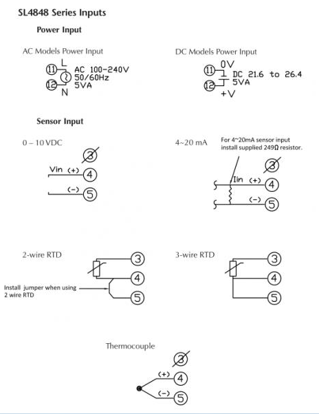

solo controller SL-4848-RR
solid state relay(AD-SSR640-AC-280A)
circuit breaker(WMZS1B40)
here are a couple wiring diagrams for the controller:

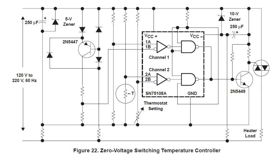

  • Hello John, Thank you for posting in TI's Forum.
    110V is derived from a dual tap transformer from the AC Mains at the power pole.
    Here is a picture to describe it.
    Each 110V line is out of phase resulting in 220V  Line to Line.
    A load would be connected between the two 110V lines.
    So breaking the path to the load, your heater, only requires one switch to open the current path.
    110V in your home wiring uses one of the phases.
    Your system may be different though, and there may actually be 2 individual 110V heaters.
    You need to see how the Kiln is wired.
    The SN75107 datasheet has a few ideas for thermal control circuits.
    TI does not make the Triac shown in Figure 22, nor the transistors, thermistors, but this shows the concept.
    Figure 22 shows a heater, perhaps in a kiln, running off 220V, with the heater element connected Line to Line.
    Only one switch is required to control the current flow.
    Again you need to check the schematic of your kiln to see how the heater element(s) are wired.
