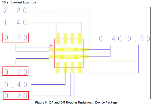

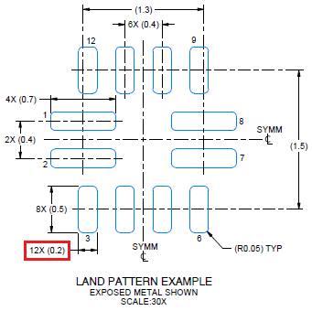

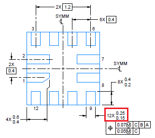

Hi Team,
The following red part dimension of TUSB211 shows ~0.25mm in current datasheet.
On the other hand, "Layout example" and "Land Pattern example" shows the line width is 0.2mm.
Is it no ploblem to follow these examples?
I believe the line width=0.2mm is recommended as "Layout example" and "Land Pattern example" refered however would like to confirm just in case.
