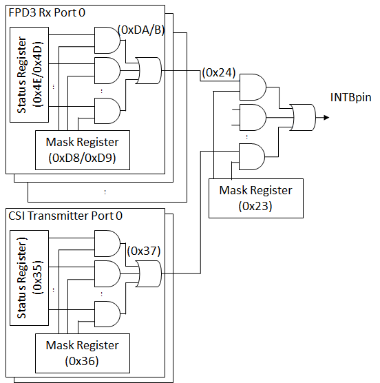

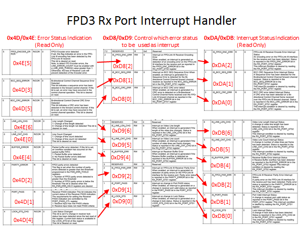

In order to understand the interrupt handling of DS90UB964-Q1, I have summarized as drawing below.
Can you help to check?

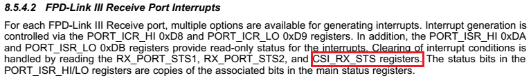

Also, where is the "CSI_RX_STS" registers? I cannot find out from datasheet.
