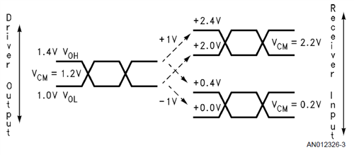

  • Q1. Correct
    Q2. Correct. These are Vcc voltages.  There is no separate standard for 2.5, 3.3 or 5V supply.  In all cases the LVDS receiver needs to support 0 to 2.4V common mode and 100 mV differential voltage threshold.
    There are variations of LVDS for lower common mode, e. g. sub-LVDS which uses 0.9V common mode (typical, instead of 1.2V in LVDS).
    Q3. The LVDS driver should have a typical common mode voltage of 1.2V. To allow for up to  1V of ground voltage difference, the driver common mode voltage needs to be between 1V and 1.4V.  This will make sure that the receiver will see a common mode of 0 to 2.4 V. The diagram below shows how this works.
    Q4. The Abs Max LVDS Receiver Input Voltage for DS90CR288A is also from -0.3 to Vcc+0.3 V (which is 3.6V), just like DS90CR482.  For both devices this is Abs Max, not operating spec.
    The 2.5V common mode is not compliant with spec.  They need to reduce it. Please note that this is not a limitation of our devices; this is LVDS standard. Devices from other manufacturers also follow that standard.

    As what you've said above ,Four LVDSs have different values of voltage, is it true?
    The datasheet shows Vcm is 1.2V. Compared with picture above ,how to explain that?
    Wish your reply ,thanks.
    The picture above also shows that Vcm at transmitter is 1.2V, just like the datasheet. At the receiver there could be ground shift causing Vcm at the receiver to be different.
