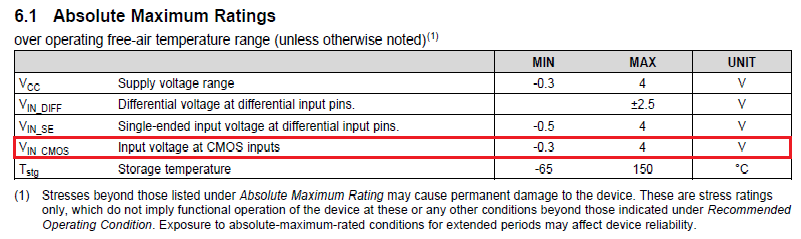

Could you tell me ABS max ratings of SCL pin and SDA pin?
I would like to know if is it possible to apply voltage to these pins when power supply of TUSB1044 is off.
Is it same as the following CMOS inputs?
If the answer is yes, I believe it is no ploblem to apply voltage to SCL pin and SDA pin when power supply of TUSB1044 is off.
