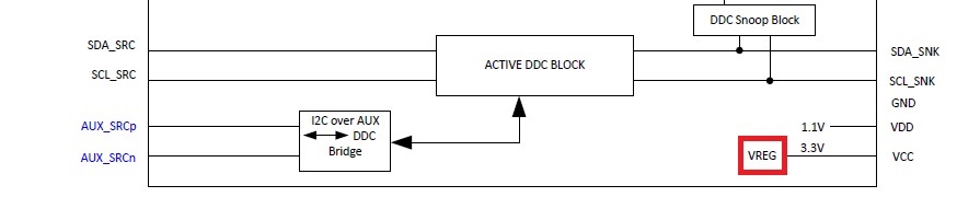

Hi, Support Team
Since DP has an internal VREG(LDO), doesn't a high PSRR LDO need as 3.3V power supply?
And also, how about 1.1V rail?
Tamio
  • Hello Tamio
    We have ripple levels, with this one you can have an idea because we don't have a PSRR reported on our datasheet. We only have the input ripple levels:
    Ripple ~30mV up to 20MHz, ripple ~20mV over 20MHz is for 1.1V
    Ripple ~45mV up to 20MHz, ripple ~30mV over 20MHz is for 1.8V
    Ripple ~60mV up to 20MHz, ripple ~40mV over 20MHz is for 3.3V
