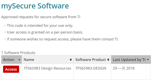

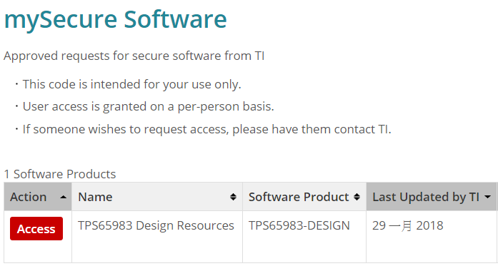

  • Hi Axel,
    The 83 will only work with 83 FW. If you have a TPS65983 on your PCBs, you must use the latest 4.xx Firmware that you can find in the MySecure Site for the TPS65983.

  • Hi Eric,
    Our device indeed used the 983 chip w/ 4.45 FW, and the configuration tool/FW downloaded by mysecuresite. Moreover, we followed Intel reference design and used the default TI PD template settings.
