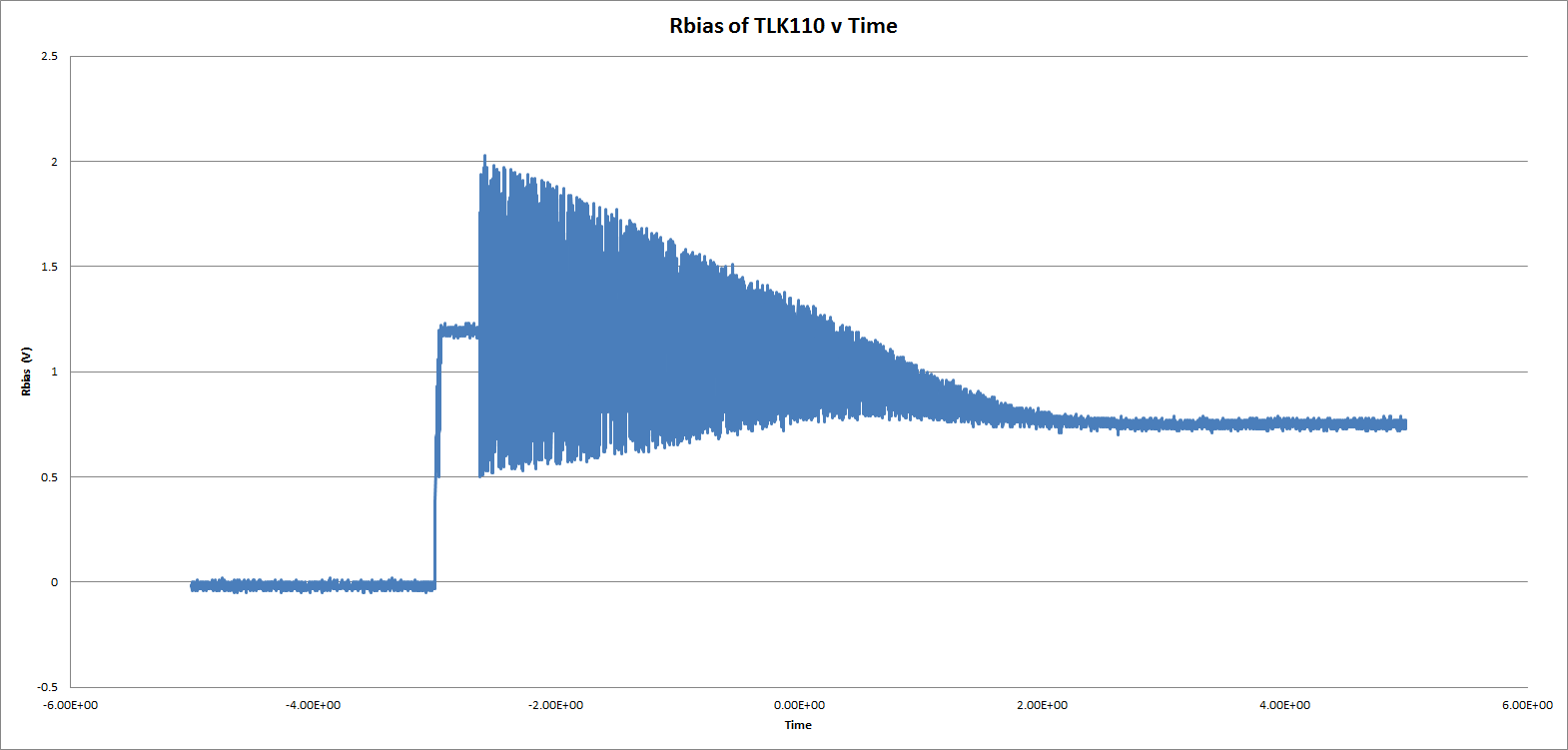

I'm using a pair of TLK110 chips to run ECAT communications, and I am seeing intermittent issues with the TLK110 responsible for ECAT-OUT.
In normal operation, the chip auto-negotiates to 100Mbps rate - Pin 27 sinks current, LED turns on, and we can establish communications with downstream devices.
In the failure mode, here's what I've observed:
1. Pin 27 does not indicate that the data rate was auto-negotiated to be 100Mbps. LED does not turn on.
2. Rbias shows an oscillation at ~1.5MHz for ~4 seconds, then settles to ~0.7V
3. PFBOUT rises to ~1.7V, then linearly decays to ~0.5V over a period of ~4 seconds
The 3.3V supply comes up normally and is stable in both cases, and, when the chip boots up normally, PFBOUT and Rbias are stable within their normal operating voltage range.
Can you share what is the function of the internal 1.55V LDO (PFBOUT), Rbias (1.215V across 4.87kohm resistor), and any idea why we might be seeing this behavior from the chip?
