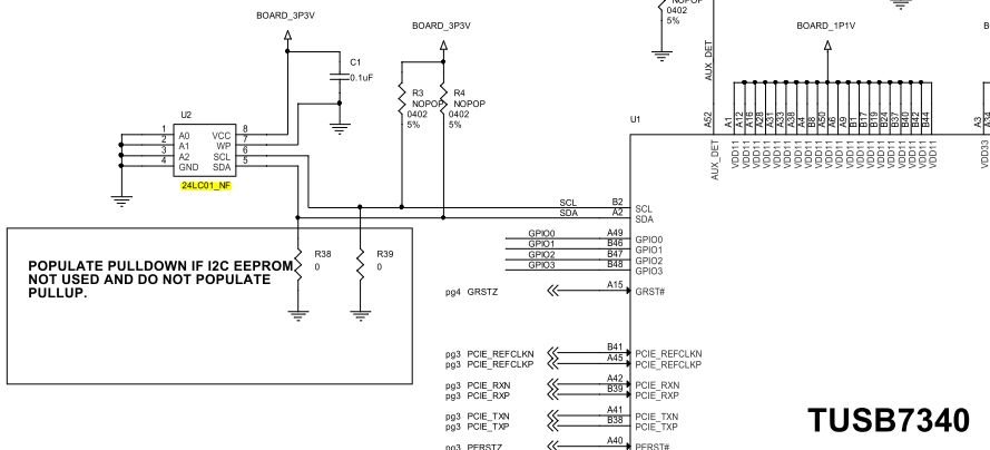

Please let me ask about EEPROM on TUSB7320EVM. I know that TUSB7320 is now NRND but the customer has EVM and plan to evaluate it.
  1. Does this EEPROM has any information, for example default value or something?
  2. How can they change the information in this EEPROM?

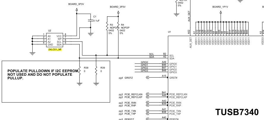

    1. Does TUSB7320 EVM have external EEPROM? Attached is schematic from user's guide.
    2. How to program this external EEPROM?

  • Satoshi-san,
    My apologies for the delay on this response.
    The TUSB7320 EVM board has a placeholder for the EEPROM, but it isn't populated.
    You can program the EEPROM using any EEPROM programming tool or I2C master before placing the EEPROM on the board; we do not provide tools that can help with that.
