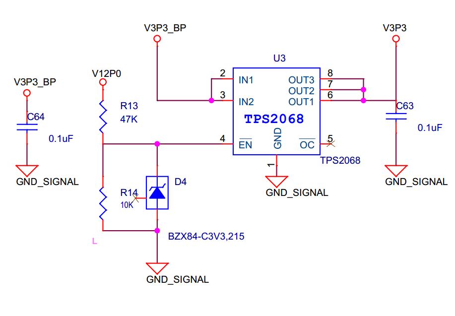

TPS2068: TPS2068 - Reverse current protection
Part Number: TPS2068
HI,
We are planning to Use TPS2068 for switching ON/OFF of 3.3V based on a 12V enable .
Please see the below circuit .
The input V3P3_BP need to be switched to output if the V12P0 is 0 at the Enable . When 12V is present the switch should be off and there should not be any reverse current / voltage that should come from the out to In .
also can i leave the OC pin floating
is this ckt ok for my applaication
