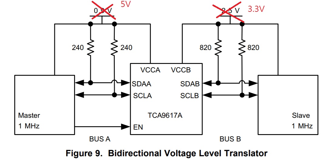

HI Sir
Does TI have level shift solution can support 5V to 3.3V
Due to I saw TCA9617A need to do VCCA < VCCB
  • Hello Kai,
    I2C is a bidirectional protocol, thus that means you can switch where the master and the slave is. Place slave on Vcca side with 3.3V then place master with 5V to Vccb. I would also recommend using the TCA9617B, it has powered off high-impedance bus.
