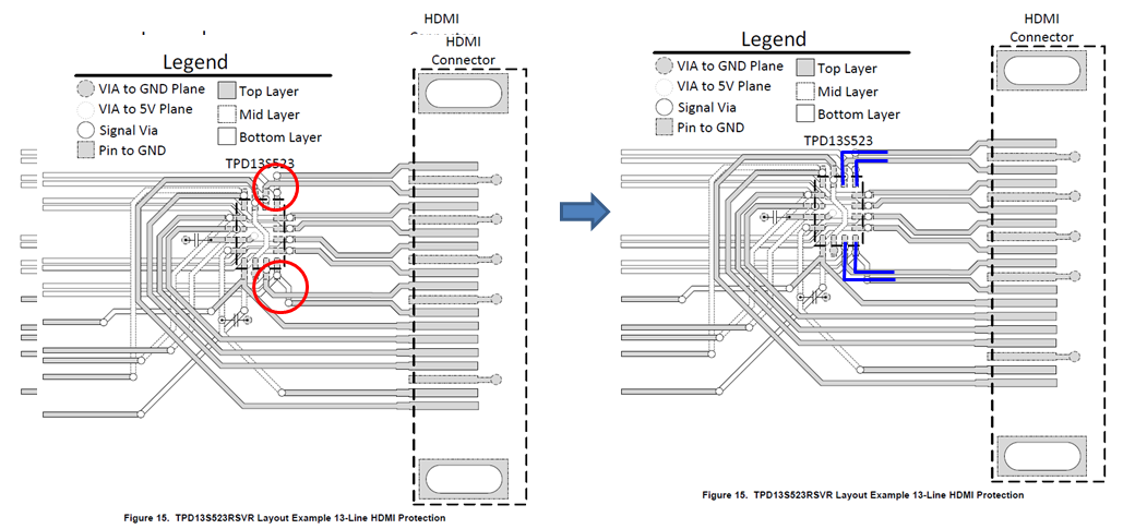

Hi Team,
in the RSV package the routing is not optimal anymore. Is it possible to swap D+ and D- pins to make the routing easier?
Thank you for your time!
Simon
  • Simon,
    It is possible to swap the D+ and D- pins, but you will have to do it at both the input and output of the device. The reason you have to do this is to prevent channel inversion on the HDMI link.
    I cannot fully tell from you diagram if this will help in the system. I think that it will just push the via from the output to the input, but you can take a look at that option.
    Chuck
