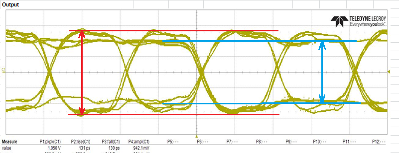

  •  Hi Kuramochi,
    The current settings look like they are achieving the correct de-emphasis level.
    The Red arrow shows the peak to peak value of approximately 1080 mV   (Passes 800mv to 1200mV specification)
    The Blue arrow shows the de-emphasized value of approximately 800mV or -2.6 dB  (Passes -2.5 dB to -4.5 dB specification)
    To me this looks like a measurement error by the protocol tool.  This waveform will work very well in a GEN1 PCIe system.
    Lee

  • Hi Kuramochi-san,
    I highlighted the waveform output file.  The input file was different.
    Lee

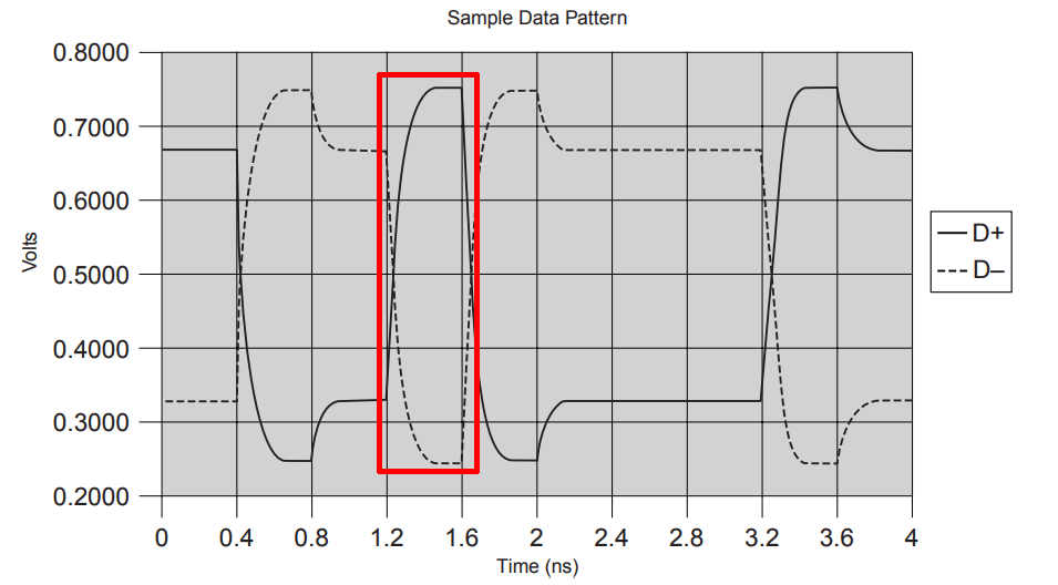

    I think that transition bit should not be implemented deemphasis as below.
    However observed waveform is implemented de-emphasis on transition bit,
    Can we delay to implement de-emphasis as red broken line on the above attached file?
    or is there any way or confirmation to pass the compliance test?

  • Hi Kuramochi-san,
    The de-emphasis applied from our DS80PCI102 Tx output is not necessarily one bit time long. It is possible for the de-emphasis to occur in less than one bit time length after a transition, especially at lower data rates such as 2.5G. We do not have configurable control over how long the de-emphasis waveform is.
    For tests that require you to implement either -3.5 dB or -6 dB on the transmitter, we have been able to pass compliance tests after applying the corresponding -3.5 dB or -6 dB settings with the DEMA / DEMB pin settings or by register control, then run with the compliance software.
