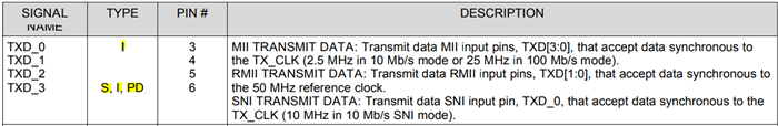

2."I" and "S, I, PD" are described in the explanation of the TXD 0 to 3 pins.
 Please tell me the reasons for the two types.
 In addition, the notation of "I" is a 3-pin the target. Is my understanding correct?
