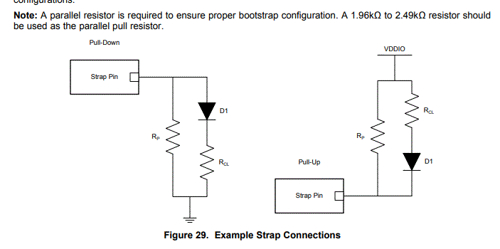

On the our customer's board, our customer could not get  the FLP signal in Oscilloscope.
<Contents>
1. power up
2. After 150ms, reset release(L->H)
3. They could not get  the FLP signal in Oscilloscope
And then,
1. MAC I/F : RMII, slave configuration
2. Clock : 50MHz±50ppm
3. RBIAS voltage : 1.0V
-> We think that it doesn't matter about hardware.
<Question1>
In spite of Hardware Bootstrap Configurations, we thinks after reset reset release(L->H), FLP outputs.
Our customer's Hardware Bootstrap Configurations are all default.
Does it requre EEE_EN=1 for FLP?
Is our recognition correct?
<Question2>
Does FLP output after power-up 1.5s?
If you have some advice, could you let us know?
