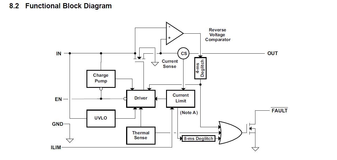

  • Hi, Harukawa,
    Does functional block diagram in datasheet satisfy customer's request?
  • Thank you for your reply.

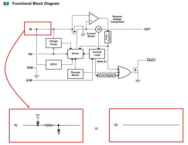

    I understand that Figure 8.2 shows the internal circuit configuration of TPS2553-Q1.
    However, what the customer want to confirm is the presence or absence of a clamp circuit (ESD diode) at each pin (e.g.IN input).
    Q.
    Is it possible to present an internal equivalent circuit as shown below, for example?
    -Harukawa
  • Hi, Harukawa,
    There is a clamp circuit at each pin and it's ESD diode. But the circuit is not like what you attached, sorry that I can't present any equivalent circuit because it's kinda confidential.
    Bob
