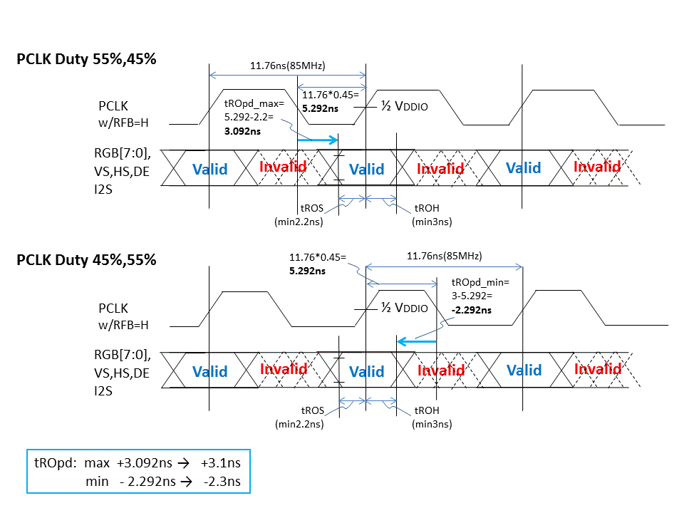

My customer thinks it is very hard to understand DS90UH926Q-Q1 datasheet Figure 6 Output Data Valid Times.
The customer asks whether the figure (A) or (B) below is correct.
I think (A) is correct. Because there is following descrition in the datasheet page.11 table.
  tROS  |  Data Valid before PCLK – Setup Time
  tROH  |  Data Valid after PCLK – Hold Time
However, if (A) is correct I can not understand why data valid time is so narrow and not related to PCLK frequency.
Please let me know the answer.
