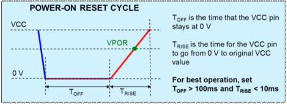

    "Q1.Do I need a special power up sequence for the PCA 9518?"
    -Though I have no heard of this device having a specific power sequence you may want to adhere to the power up requirements that some of our other PCA devices require:
    "Q2.When it is enabled after the power supply startup is completed, the bus voltage goes from low to high.
         Is it a valid way to return from abnormal state?"
    -I assume you mean the bus voltage goes from high to low and not low to high. It sounds like if this is something occurring at power on, then it is related to the ramp rate of the Vcc pin or maybe the time off is not sufficient. Another power cycle sounds like the best approach. I would have to see waveforms when this bug occurs to get a better understanding.
