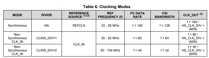

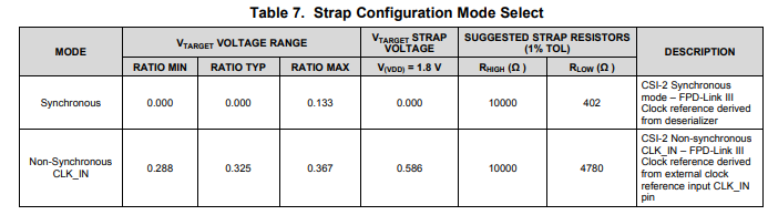

The Table 6 on the datasheet of the DS90UB953 shows that it can be operated in 3 modes. However, there are only 2 modes on Table 7. I wonder what are the correlations of the modes in two tables.
Thanks!
