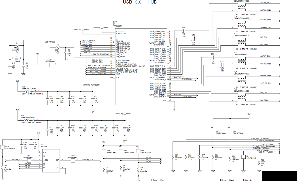

We are having an issue getting the downstream ports of the HUB into CDP mode.  The HUB works in CDP mode when not connected to the PC Host.  When we use Windows to make the connection upstream we lose CDP mode on our downstream ports.  We believe this is not a TUSB80xx problem but are not sure where to look in Windows to ensure that it enables CDP mode.  Are you familiar with tools or steps in Windows to have this work?

    There are no status registers in the TUSB8041 so I would not expect the values read back to change. The hub is configured using EEPROM / SMBUS or pin configuration at power on reset and does not update its configuration until the next power on reset. Can you post a copy of the customer schematic? The TUSB8041 needs to have battery charging enabled at power on reset via pin configuration or EEPROM / SMBUS and it must be able to control VBUS to change from DCP to CDP mode. I would also like to see a failing CDP test log versus a passing CDP test log.
    JMMN
    Below is the schematics for your review.  If you need more detailed schematics please contact me at Jason Haedt in the address book.  Currently we are not using an EEPROM and SMBUS. The EEPROM below is not installed so we are relying on the hard lines for proper configuration.  I have currently grounded pin 39 to enable SMBUS mode so I can read out the configuration registers.
    Not shown are the load switches present in the design.  These use the BATFET enable lines.  The CDP mode works when no host is connected but no longer works as soon as a host is connected.  So we know the load switches are working properly.
  • Hi Jason,
    CDP charging mode is when the upstream port of the hub is connected to a host and configured. DCP charging mode is when the upstream port of the hub is not connected. When the hub goes from unconnected to connected, the VBUS on the downstream ports needs to be toggled low to force the downstream devices to exit DCP mode and enter CDP mode - do you see that occur?

    Something we noticed early on was that there is some conflicting information in the datasheet. The circuit in our hardware is configured as specified by the datasheet, which calls out the actual resistor values. On our board, I am measuring about 0.5V on USB_VBUS when USB_VBUS2 is connected to the 5V host.
    Table 1 from the datasheet specifies >4V on VBUS for CDP mode yet the maximum recommended voltage is 1.155V.
    It is pretty easy to assume, the mistake is the >4V spec but maybe this is worth looking into based on what we are observing.

  • Hi Jason,
    The USB_VBUS pin is a VBUS sensing pin.
