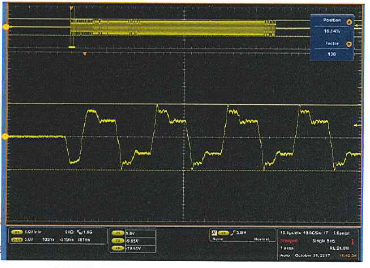

About DP83848K, measured TD+(16 pin) and TD-(14 pin) by differential probe.

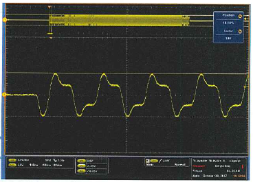

These waveform ware not smoothed, but competitor is smoothed on the same condition, waveform is attached.
(100Mbps is no problem(clean waveform), 10Mbps is only no-smoothed.)
・DP83848K
・Competitor
I think that the reason is  below, is it correct? If there the other possibility of reason, please let me know.
・Is DP83848K become these waveform on the condition of 10Mbps by internal circuit?
・Cable length is 20cm~1m. Is very short length cable influence any problem to DP83848K?
