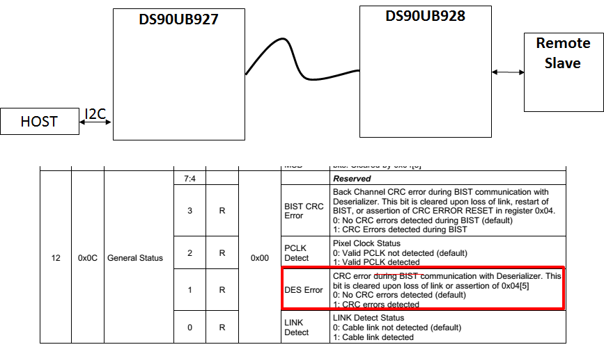

My customer has seen the error behavior on their system which use DS90UB927-Q1, DS90UB928-Q1 and remote slave as drawing below.
According to the error log which is sitting next of HOST processor, when error occurrs, the DES Error flag (0x0C[1]) is triggered.
From their debug, customer has found that SCL Low tiime and High time setting of both DS90UB927-Q1 and DS90UB928-Q1 are not correct.
(it's like, they left both registers as default, even though they use 400KHz I2C communication.)
Do you think this invalid SCL Low / High Time setting cause DES Error (0x0C[1])?
It's appreciated if you can elaborate  the "DES Error" itself such as details of the data package (I2C & GPIO?) which CRC checked.
