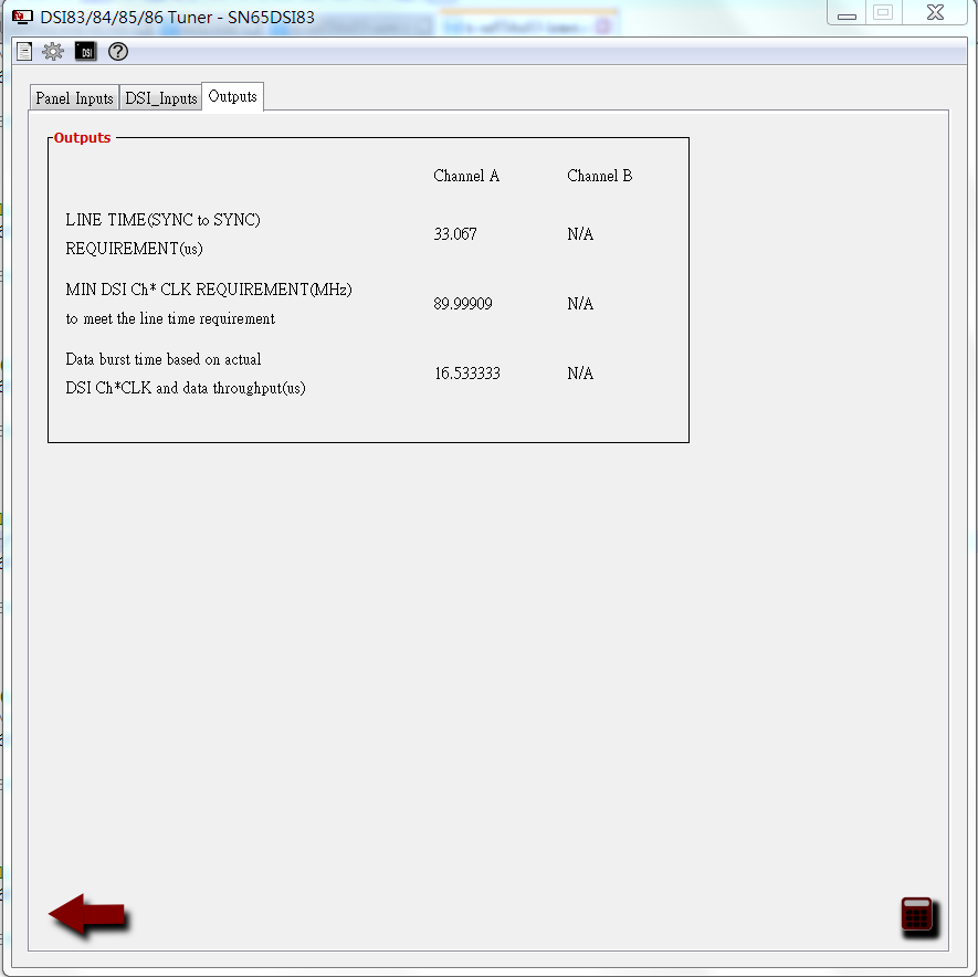

SN65DSI83: LVDS display will repeat showing red, green, blue, black, white, checkerboard, grey
Part Number: SN65DSI83
Processor: NXP i.MX8
Panel: Innolux G070Y2-L01
|                               |     MIPI DSI      |                             |         LVDS        |                                       |
|          i.MX8          |   -----------------> |    SN65DSI83     |   -----------------> |  Innolux G070Y2-L01 |
We use SN65DSI83 to transform MIPI DSI signal to LVDS display.
When we turn on test pattern mode (CHA test pattern is 1), we can see the test pattern.
But when we turn off test pattern mode (CHA test pattern is 0), LVDS display will repeat showing red, green, blue, black, white, checkerboard, grey.
Here are some questions.
1. What will SN65DSI83 operate if test pattern mode is turned off? Will it just transform MIPI DSI signal to LVDS signal?
2. If we set some wrong CSR values, will SN65DSI83 generate the special pattern?
Please help to give me some advice.
