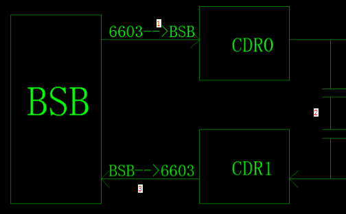

Hi team,
My customer is using DS280DF810 and they don't have much experience on it.
They want to know what kind of settings on DFE/CTLE/TX FIR they could start tuning from.
The architecture is as below. There're 3 traces.
1st trace is from BSB to CDR0, 1.6~1.8inch
2nd trace is from CDR0 to CDR1, 1.9~4.4inch
3rd trace is from CDR1 to BSB, 1.6 inch
The length has some variation because between same trace but different channels, the length is not very constant.
The temperature range is -40~70C. And board material is TU862/EM370D.
Could you kindly help?
Thank!
    These traces are very short. I don't expect much if any Retimer Tx FIR post-cursor would be necessary. Similarly, on the Rx side the retime Rx EQ will likely not need to do much work. My suggestions below:
    Retimer FIR settings (for both CDR0 and CDR1)
    Main = 15
    Post = 0
    Pre = -1
    Retimer Rx setting
    Adapt mode 1 -> channel register 0x31 = 0x20
    You may also consider forcing a CTLE value of 0x00 given the low loss.
    Table 43. Set CTLE Boost Value
    STEP
    SHARED/ CHANNEL REGISTER SET
    OPERATION
    REGISTER ADDRESS [HEX]
    REGISTER VALUE [HEX]
    WRITE MASK [HEX]
    COMMENT
    1
    Channel
    Write
    2D
    08
    08
    Enable CTLE boost override
    2
    Channel
    Write
    03
    00
    FF
    Set CTLE boost to 0x00. Different input channel loss will require different CTLE settings.
