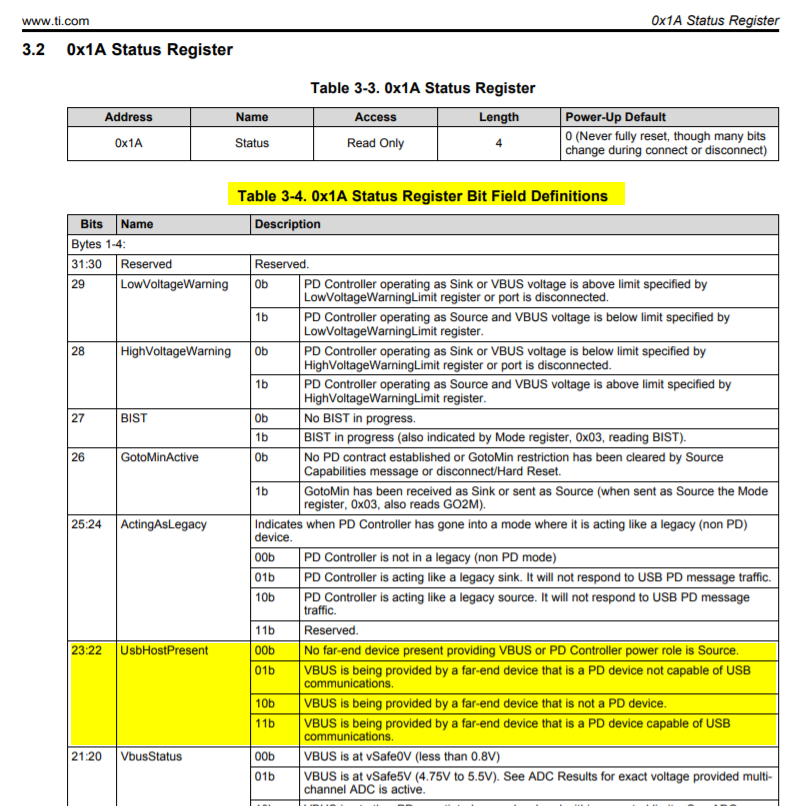

  1. Is there any known reasons that the UsbHostPresent bits may not get set to something other than [00], when configured as an UFP and VBUS is definitely present?   Using these bits by the O/S to know when charger is present, but not getting reliable results.

    1) Is there any known reasons that the UsbHostPresent bits may not get set to something other than [00], when configured as an UFP and VBUS is definitely present?   Using these bits by the O/S to know when charger is present, but not getting reliable results.
    My understanding of your question is that if VBUS is present and NOT the source, then UsbHostPresent bits will show either 01, 10, or 11. If you're template is configured as a UFP, but tone of he PowerPaths is set as a source, then the UsbHostPresent bits will show 00 when it's sourcing to VBUS (look below for table).
    Feel free to take a look at the Host InterfaceTRM here: http://www.ti.com/lit/ug/slvuan1a/slvuan1a.pdf
