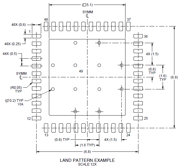

Part Number: DS90UB921-Q1
Layout example is shown in the page 48 of the datasheet.
Do you have the recommended via size?

Hamzeh-san,
Thank you for your quick answer!
Which document did you refer?
I couldn't find it...
