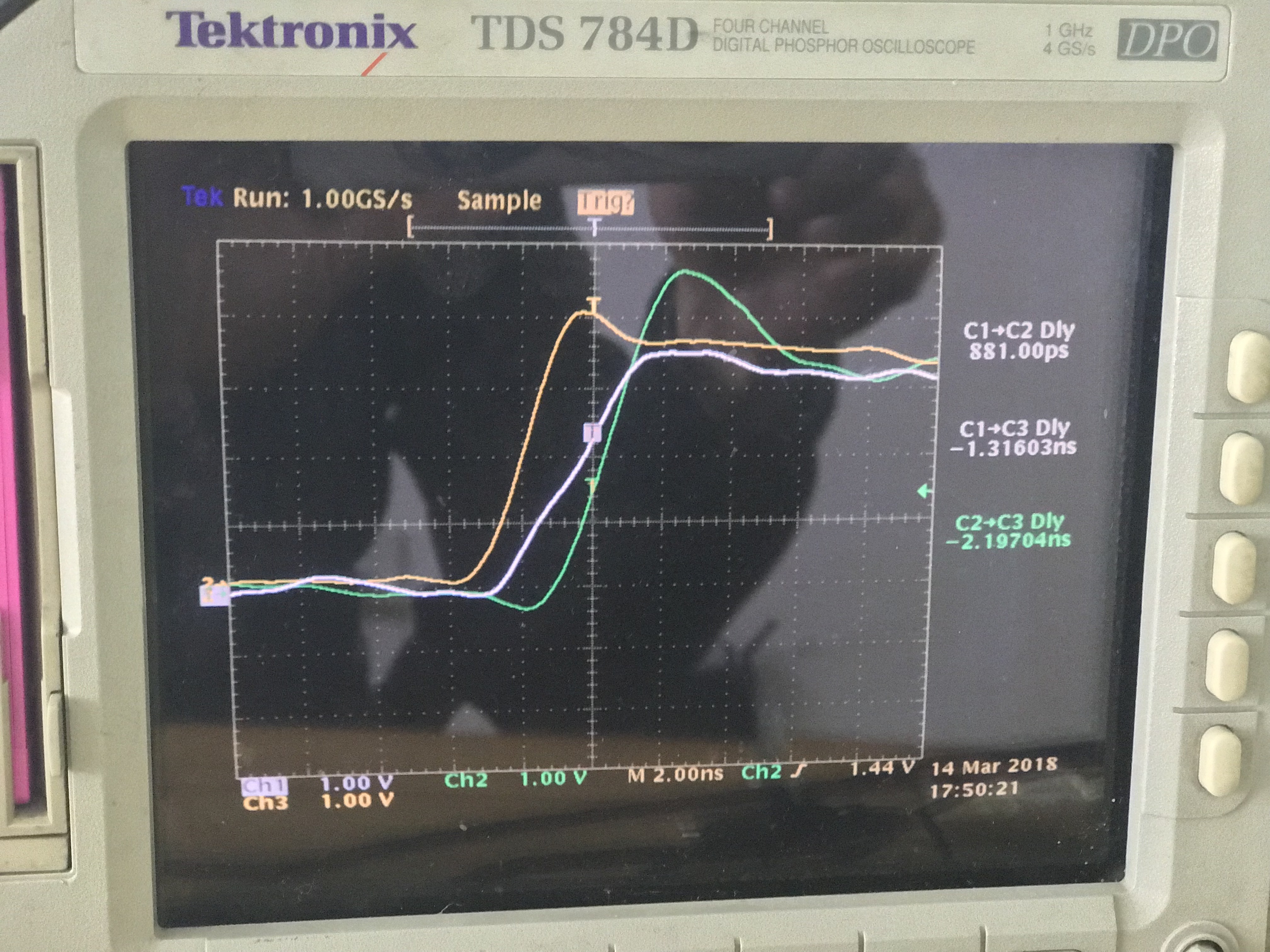

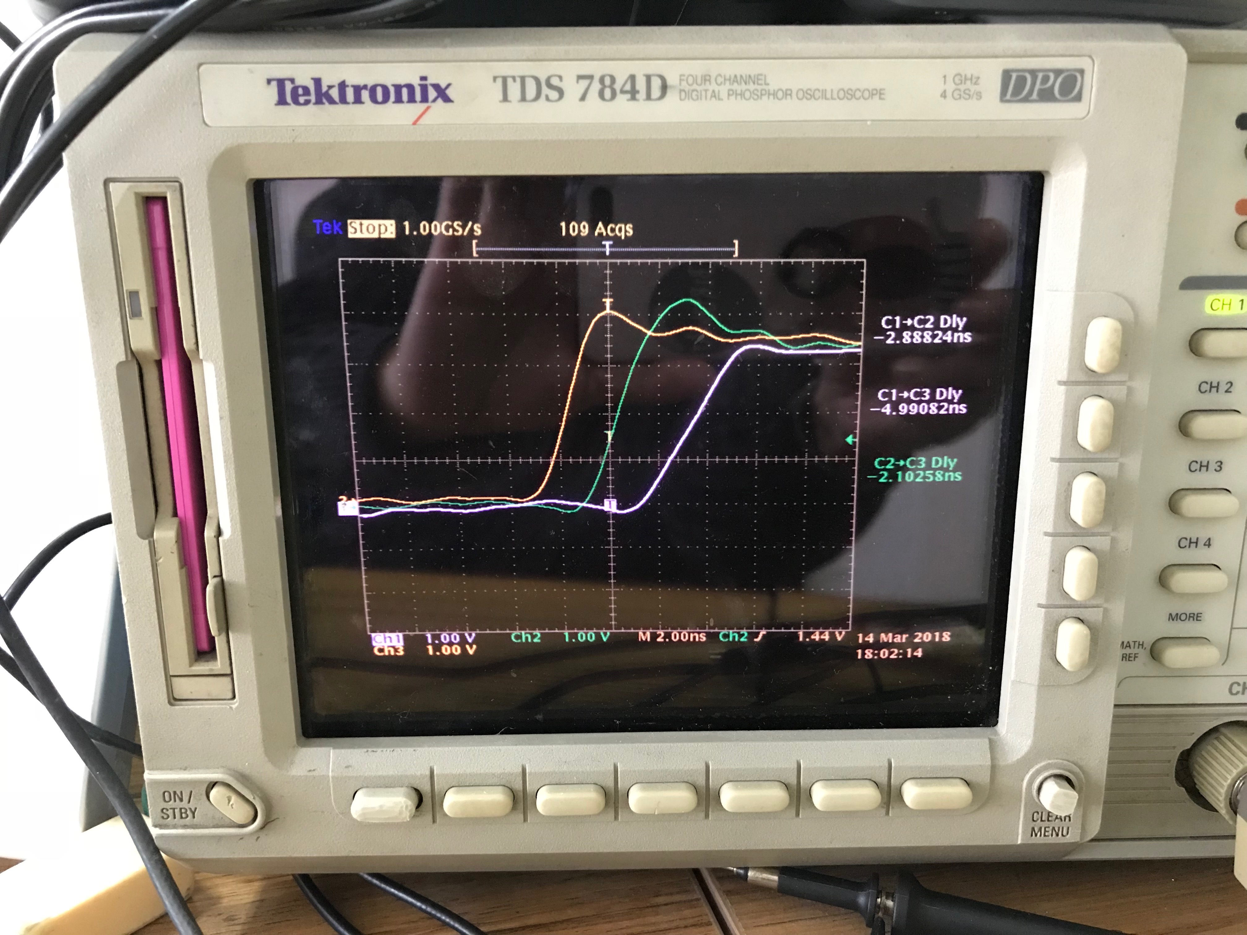

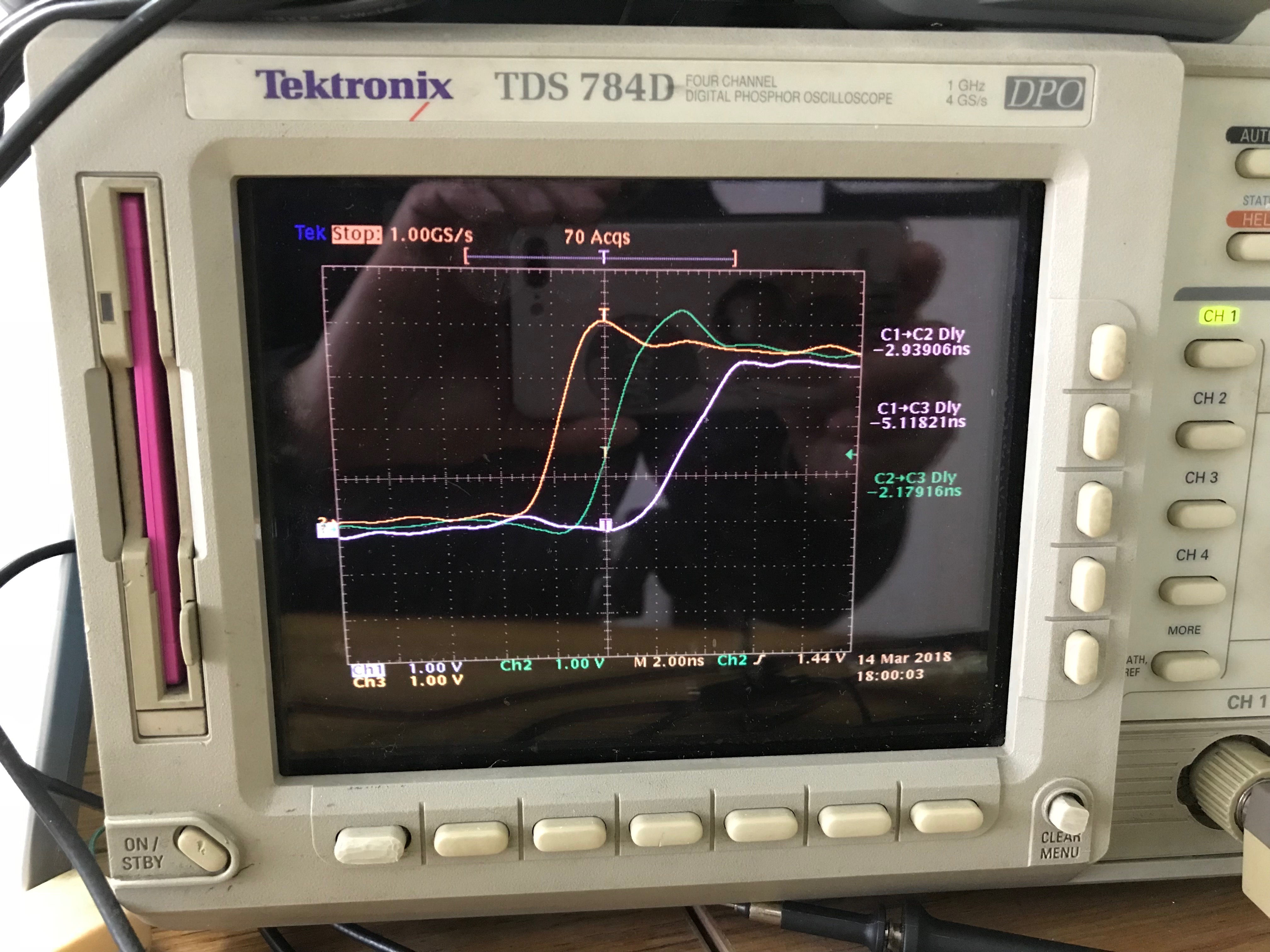

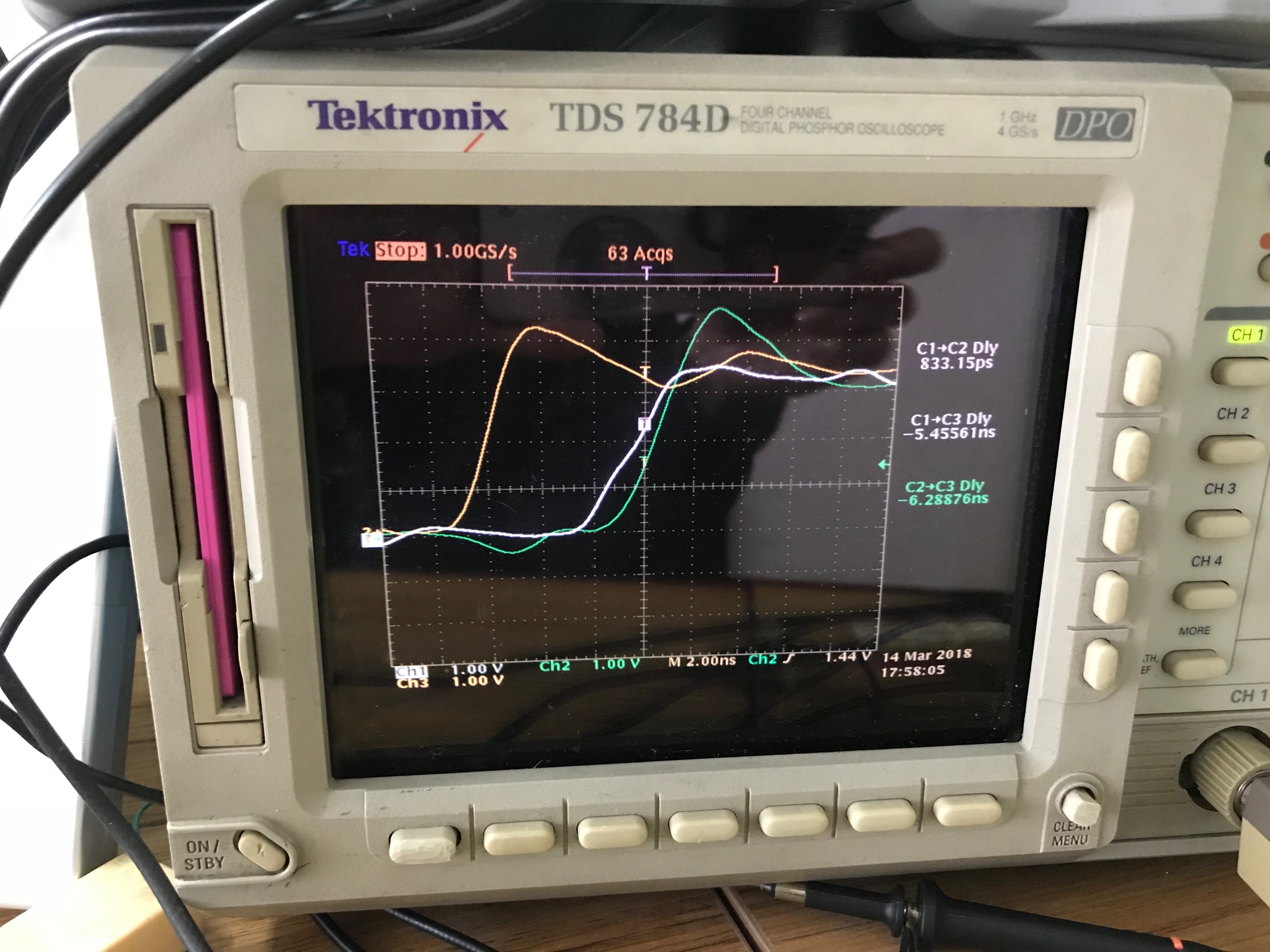

    For case A you mentioned, I do 8 times power-on test, every time phase alignment among those three signal is different. Then I try to reset the MCU only while keep the board power on, the phenomenon is same. So I only record the power on test result at followed.
    For case B you mentioned, I cannot accept PHY2's PTP function work as low as 25MHz clock, I still hope both PHY1 and PH2 have 125MHz PTP clock, so I haven't try it yet.
    Followed is my test result for case A:
    Oscilloscope setting:
    C1: PHY1's 25MHz PTP clock (Write color)
    C2: PHY1's PPS output (Green color)
    C3: PHY2's PPS output (Brown color)
    Software Sequence:
    1. Setting PHY1 to generate the first trigger signal
    2. PHY1 and PHY2 event captured, record the event timestamp
    3. Calculate the offset from PHY2 to PHY1
    4. Do the step adjust
    5. Setting PHY1 to generate the second trigger signal
    6. PHY1 and PHY2 event captured, record the event timestamp
    7. Reconfirm the offset from PHY2 to PHY1
    In followed eight times test log and waveform, in the step7, PHY1 and PHY2 has no time offset, that means synchronization is success. However the waveform have phase error, because event timestamp's accuracy is 8ns, so I doubt PHY1 and PHY2 didn't synchronized actually.

    First time, snapshot from oscilloscope:

    Second time, snapshot from oscilloscope:

    3rd time, snapshot from oscilloscope:

    4th time, snapshot from oscilloscope:
