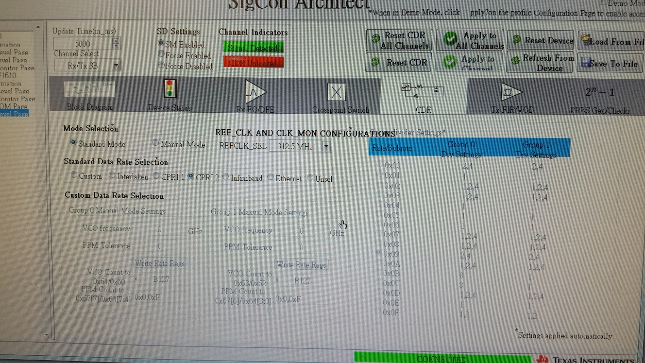

DS125DF1610: ds125df1610 unlock at 6.144G
Part Number: DS125DF1610
Other Parts Discussed in Thread: USB2ANY, TLK10232
DS125DF1610: use 312.5Mhz reference clock
When it set to CPRI  mode, it can work well with 9.8304 and 2.4576G can work well.
When I change to CPRI2 mode, 6.144G, it can not lock. tester show rx frequency is 3.2G.
When I change to 3.072G, it will disparity error.
I load ext_10G_config and modify High level page CDR and cross connect option only. Do I need anything else?

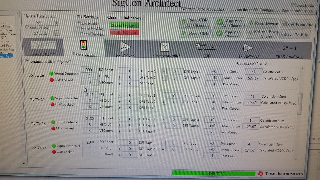

  • I use USB2Any to setup it. 0x2F= 0x96 0x64=0xff. it still can not work
    Please check the attach picture.
  • sometime test equipment will show rx frequency around 3.3G

  • I would suggest to try the following settings to see if they help the channel attain CDR lock
    • Set 0x0C[3]=0
    • Set 0x2F[2]=0
    • Set 0x2F[1]=0
    If the above doesn't help, you may try ref_mode=0 (this mode is only intended for lab debug)

  • After I set  as below
    • Set 0x0C[3]=0
    • Set 0x2F[2]=0
    • Set 0x2F[1]=0
    device status show CDR lock, but test equipment : receive frequency = 6.28G. somtime one side is OK, otherwise is wrong.
           0x0c =0
           0x2f = 0x90
    add
    • 0x36[5:4]=b00
    device status show CDR lock: test equipment: receiver frequency: one side is 6.28G otherside is 6.33G.
    adapt mode 0 : one side ok, otherside is 6.28
    adapt mode 1 : one side 3.3G other side no frequecy :
    adapt mode 2: without DFE : sometime can lock both side. sometime not. when it is not, frequency is 3.3G.      with continue DFE  -->  sometime will Ok. I just reset CDR and check
    adapt mode3 : with DFE  it still somtime OK. Sometime fail.
    so, even bypass reference clock, it still will lock to 3.3G.

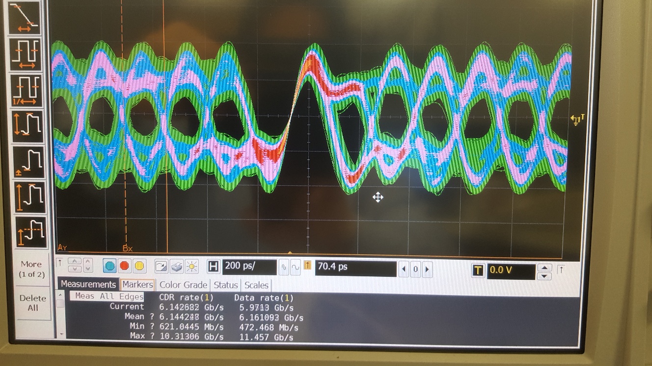

  • I would recommend that you perform a measurement of your pattern generator test equipment output signal using a scope to verify the data rate.
  • when I use test mode, I use eye pattern to check. the eye is open.

  • Have you had an opportunity to verify the data rate for the retime input signal using a sampling scope such as a Keysight DCA? I believe that's the issue here.
    Cordially,
    Rodrigo Natal
    HSSC Applications Engineer
  • please check attach file
  • Thanks for the update and result. The measured data rate looks correc, so my initial hypothesis was incorrect.
