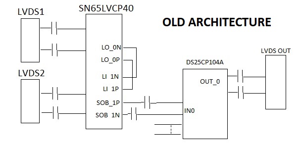

in an old post i asked the possibility to interface the mux SN65LVCP40 to a 3.125Gbps 4x4 cross-point (DS25CP104).
Now i need to update my design to interface signal source like:
- FPD-Link I/II/III
- GMSL1/2
- APIX1/2
I choose the SN65LVCP404 (or 402) for get higher datarate in place of the DS25CP104A.
My old configuration was:
My new configuration would be :
My doubt are:
1: Can the SN65LVCP404 be interfaced to an LVDS output (this output goes to a frame grbber input)? I have this doubt because from the TI selection table, the output format of this SN65LVCP404 is VML and not LVDS.
2: Does this new architecture is suitable for the signal type FPD-Link I/II/III, GMSL1/2, APIX1/2 ?
