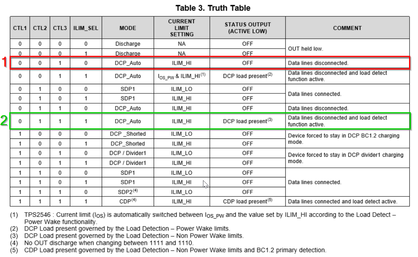

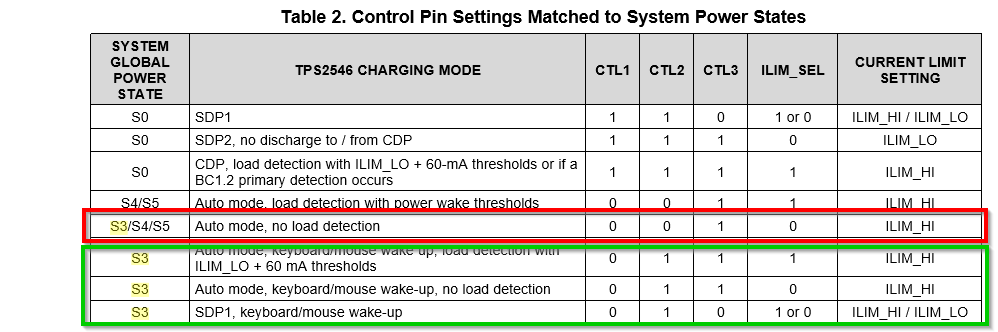

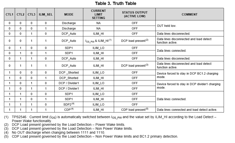

    Would you mind elaborating on the configuration that you currently have the TPS2546 in? This can be found within tables 2 and 3 of the datasheet. I also included them down below. Table 2 shows the control pin settings in respects to the system power settings while table 3 is the entire truth table for this specific part. If y'all are trying to stay in a mode that stays in power state S3, I would suggest possible trying a different configuration. I just connected my IPhone 6s to the TPS2546 EVM, and changed the control pins, running through each of the 4 different states that allow for S3. I found that only one of these states does not charge my iPhone, so this may be the state y'all are currently in. I marked them accordingly. The red box is the state that cannot charge an iPhone while the green box can charge an iPhone.

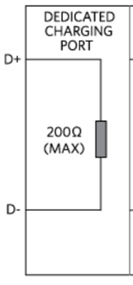

    I apologize for the late response. I used the TPS2546 EVM and got some scope captures that I think may help you. The first picture below is a typical set up for a Dedicated Charging Port (DCP). The D+ and D- lines are shorted together so the same signal should be received that is sent out determining phone connectivity.

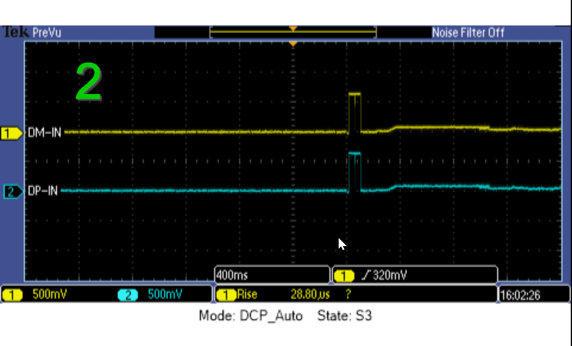

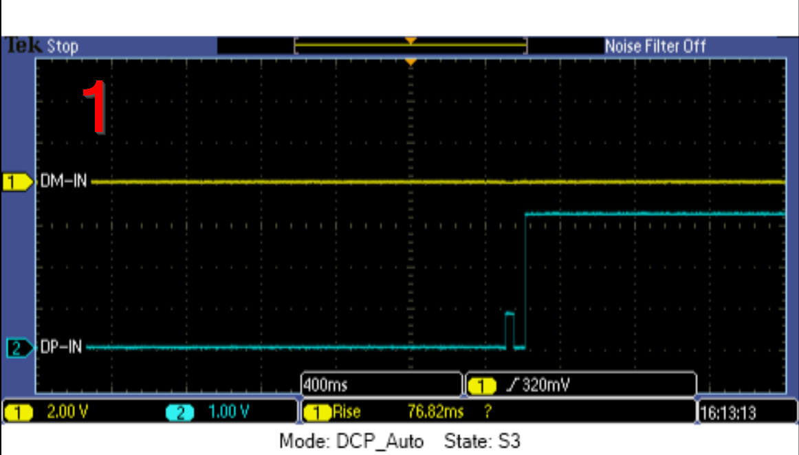

    I tested two different configurations for the DCP_Auto mode. Both of these set ups are in S3 as this is what your original request asked about. One of these configurations does not charge an iphone (box 1) while the other configuration can charge an iPhone (box 2).
    The reason why this is occurring is because something is not happening internally for set up 1 that is happening for set up 2.
    The initial signal is sent out, but a response does not occur and the D- pin rails at 3V
    For this set up, a response was received, so the phone charged as expected
