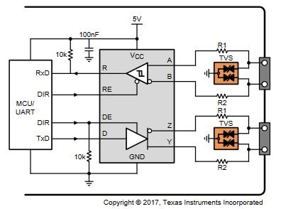

Can i get a reference design for the RS485 tranceiver Part No: SN65HVD37 that i have selected.
What protection to be given at the output side of  RS485  for this part ? can I get the reference schematic with these protection circuit?

    If you want to see a typical way of how to protect the lines instead, refer to the following picture:
    In this specific case the TVS diodes and resistors R1 and R2 help to redirect the electrical energy of a surge transient.
    If you want to have a better overview on these topics, I would suggest you to read datasheets from other devices that we have like the THVD1552 or in general THVD15xx family, since they have a better section with more examples in the application part.

    My application is to use RS485 for communication between my HMI(Human Machine Interface) and PLC .So i need a protection for RS485 so that my HMI is not affected by any kind of noise or interruption from the PLC while communication .Basically my UART voltage is 3.3V.
    So I was asking for the reference design so that it will be helpful for me.
    Should I give Fail Safe to SN65HVD37 ? And can you suggest a TVS diode part suitable for this RS485?

    In the specific picture that I posted, the TVS diodes are CDSOT23-SM712 by Bourns; you can find the full BOM on table 7 of the datasheet of THVD1552. It is not mandatory to use these TVS diodes though, it's just a recommendation.
    The SN65HVD37 device already implements receiver fail-safe, adding an external fail-safe circuitry would surely reduce the total number of nodes that you can connect to the bus.
