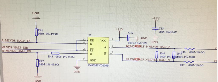

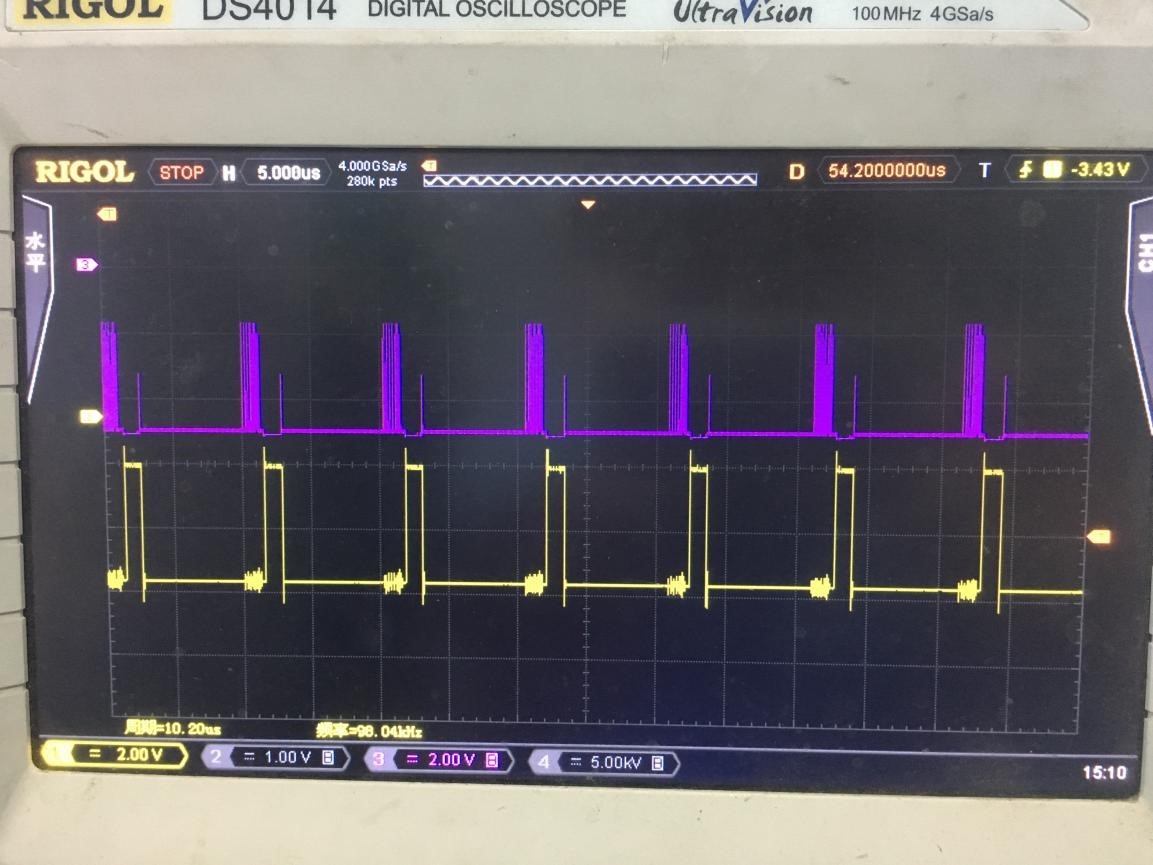

SN65MLVD206B: I found that when the sending level of the "DE" PIN is changed from high to low, a high level spike will be generated at the "R"PIN of the chip
Part Number: SN65MLVD206B
Hi:
     I found that when the sending level of the "DE"  PIN is changed from high to low, a high level spike will be generated at the "R"PIN of the chip. How can I eliminate the spike pulse ?The following is the test waveform, please refer to(the blue is data ,the yellow is enable )thanks a lot.
    As a start please check that your design and layout follow the recommendations in the datasheet. Please pay special attention to bypass capacitance (section 9.2.3.2). Another thing to do is to try to reduce the spikes on the input signal to the enable pin which seem to have significant spikes when it transitions high to low and low to high.
