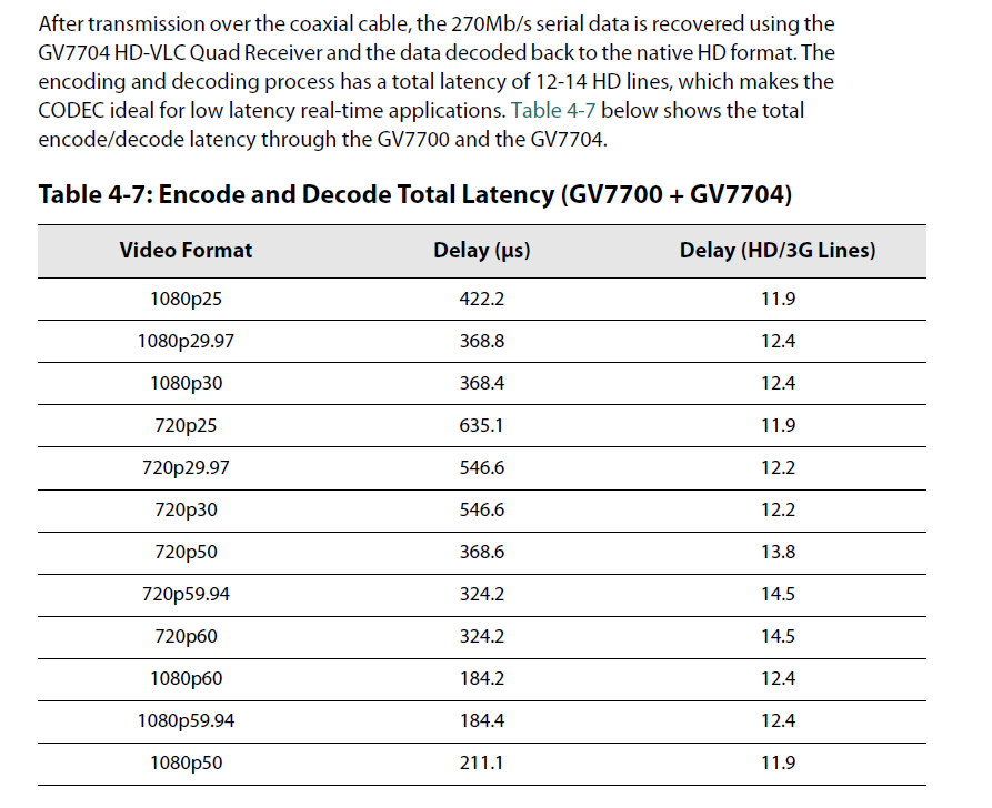

Hello, I am looking into using FPD-Link III to serialize/de-serialize an MIPI-CSI2 signal. Specifically interested in "DS90UB953" and "DS90UB954" as a pair.
But I can't find any description about the transmit latency of these two devices in related datasheets (the time between a frame in and out, which is very important in our application).
Could someone help me find these data? Appreciate it.
