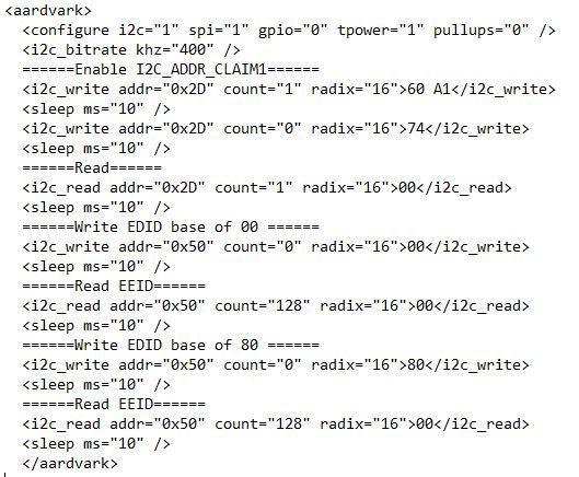

below is an example script of how to access the EDID using direct mode. Customer confirmed this EDID Access is okay. .
Customer need an example script of how to access DPCD register like script above ?
Would you help me to get example script of how to access 0x00000h DPCD register below to read data ?
JH.

    Please, use the attached script.
    <aardvark>
        <configure i2c="1" spi="1" gpio="0" tpower="1" pullups="0"/>
        <i2c_bitrate khz="400"/>
    ======Enable I2C_ADDR_CLAIM1======
       <i2c_write addr="0x2D" count="1" radix="16">60 A1 </i2c_write> <sleep ms="10"/>
       <i2c_write addr="0x2D" count="0" radix="16">74</i2c_write> <sleep ms="10"/>
    ======Read======
        <i2c_read addr="0x2D" count="1" radix="16">00</i2c_read> <sleep ms="10"/>
    ======Write EDID base of 00 ======
       <i2c_write addr="0x50" count="0" radix="16">00</i2c_write> <sleep ms="10"/>
    ======Read EEID1======
        <i2c_read addr="0x50" count="16" radix="16">00</i2c_read> <sleep ms="10"/>
    ======Read EEID2======
    ======Read EEID3======
    ======Read EEID4======
    ======Read EEID5======
    ======Read EEID6======
    ======Read EEID7======
    ======Read EEID8======
    </aardvark>
