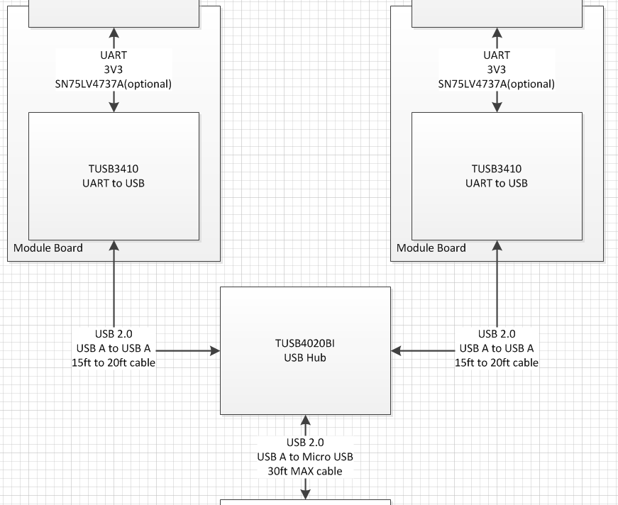

I have a customer who wants to convert a UART signal over the distance of about 30 ft.
I was going to suggest that he creates 3 modules, then have the USB standard which can go the distance be on cables rather than the UART signals.
-        2 modules that convert UART to USB 2.0
-        1 module which will act as a Hub that will communicate with a tablet
I did a quick search and these are the devices I was considering:
-        TUSB3410 (UART to USB 2.0)
-        TUSB4020BI (a hub to take 2 USB 2.0 signals in and output to 1 USB to tablet)
Are there any other devices you would recommend to do either of these applications?
