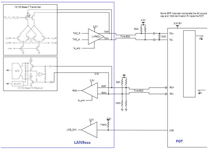

we are experiencing problem interfacing DP83822IF PHY to single-mode SFP optics transceiver. We are using “DP83822 EVM” kit with SPF port with Finisar FTLF1323P1BTR transceiver. PHY is connected to MAC over MII interface.
Problem is at RX side of transceiver/PHY. About half of packets are lost during transmission. TX side is working OK.
Transceiver is 100BASE-FX single-mode. We tried other multi-mode transceivers (Avago) and those were working fine.
For configuration we are using Bootstrap pins. (We are only enabling FX_EN bit).
Our hardware connection looks like this (Although we also tried different setups):
Do you have any idea where the problem might be or what else can we check?

  • Hi Vaclav,
    The DP83822 has a current mode line driver. It requires 0.1uF DC blocking caps on both the RD and TD pins because of the biasing.
    Please also have 49.9 ohm pull-up resistors on the TD and RD pins between the PHY and the DC blocking caps.
    Please see section 9.2.2 for a recommended configuration.

  • Hi Ross,
    we connected PHY and transceiver just like is described in section 9.2.2. (Blocking capacitors and pull-ups). But problem is still same. About half of packets are lost during transmission (Tested with ping command).
