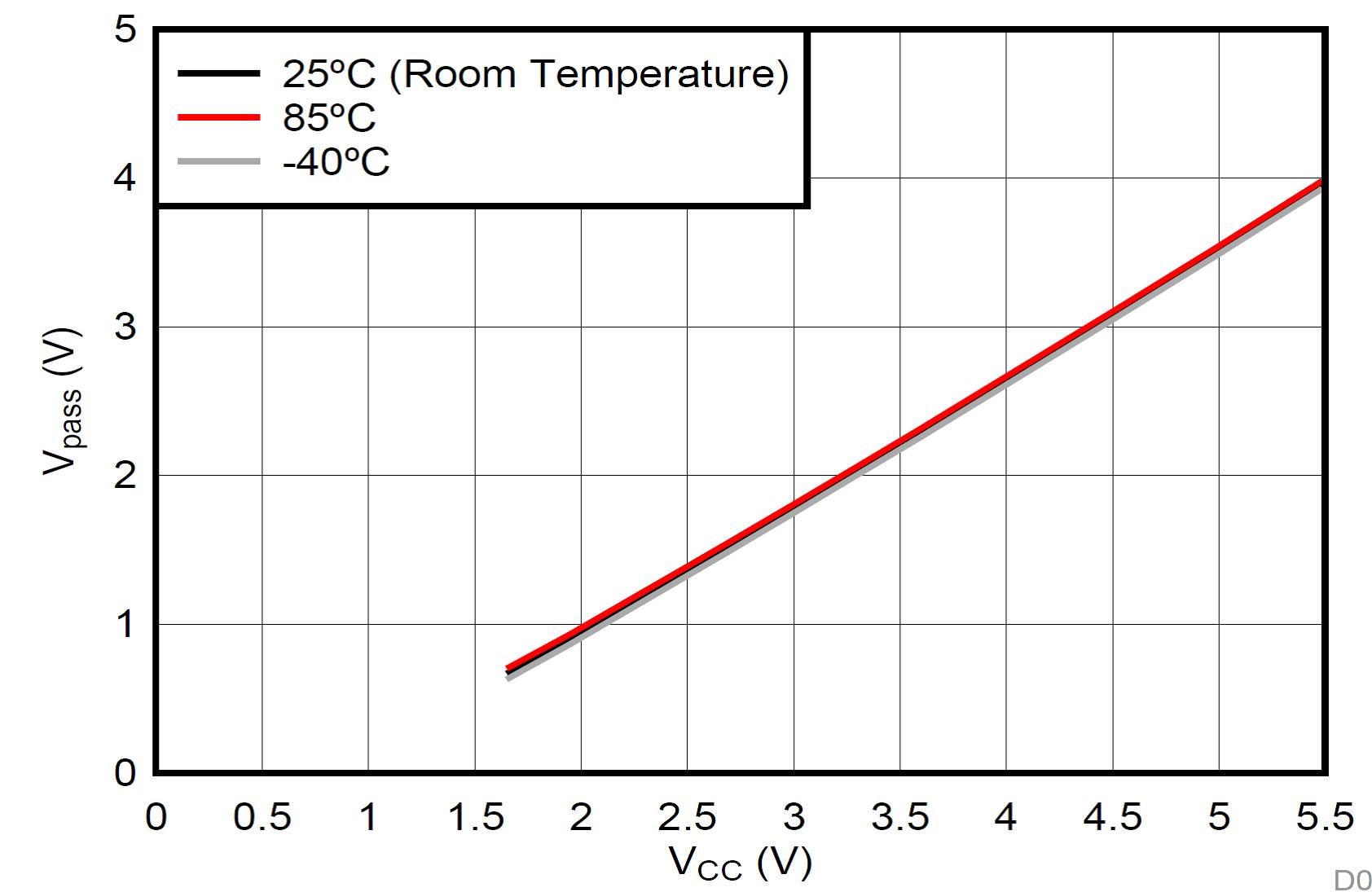

Hello Team,
If I use TCA9544A with VCC 3.3V, host with 3.3V, and slave with 1.8V, will the I2C communication work?
Host 3.3V + TCA9544A VCC 3.3V + 1.8V Slave
My thought is due to TCA9544A VIH min VCC x 0.7 = 2.31V, the slave's VOH will not exceed 2.31V with 1.8V. So above configuration I2C communication will not work. Please share any comments.
