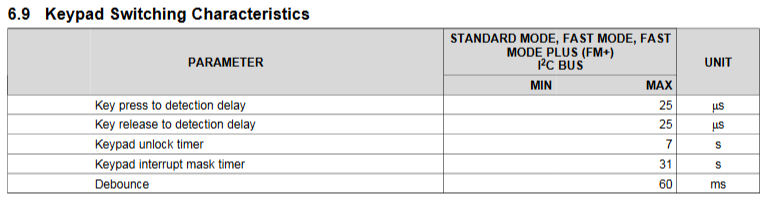

    If we use this chip in our design we would be configuring all GPIOs as inputs. (No matrix, no scanning, just to get extra PIOs, a bit of debounce, limited ESD protection and the pull ups).
    From the description in 8.6.2.15 (Debounce Disable Registers) I thought we would have ~50 uSecs of debounce in GPIO only mode. 25 mSecs would be too much latency for our application so I really appreciate any more light you can shed on this register and any latency to expect when used in GPIO input mode.

    "From the description in 8.6.2.15 (Debounce Disable Registers) I thought we would have ~50 uSecs of debounce in GPIO only mode."
    Debounce time seems to be a maximum of 60ms. I would probably trust this section of the datasheet. As stated previously, I do believe the values in the register will be a delayed value of the last two scans (25ms apart so the maximum delay would be 50ms if I understand correctly). It may be better to look at our IO expanders as it seems the delayed values may not be ideal for your application.
    We do have IO expanders that have ESD protection and internal pull ups. One example would be the TCA9555 with 100k internal pull ups and ESD protection of 2k HBM and 1k CDM. Several package options and device is default set as inputs without the need to configure the registers like the TCA8418 would require. The only thing it doesn't have is the debounce feature.
