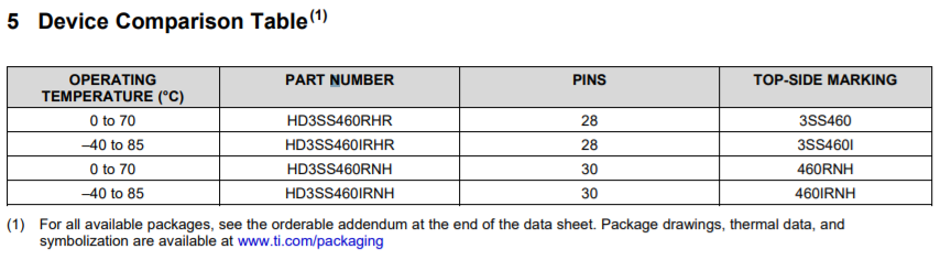

Part Number: HD3SS460
Dear Sir,
Please you kindly help provide HD3SS460 Tj range.
I didn't find on datasheet.
Thanks!
Steven

Sorry, we do not have a Tj range for this device but we do have the Operating Temperature on section 5 of the datasheet.
You can calculate the Tj using the thermal resistance(RθJA= 51.6 or 44.0 °C/W), the ambient temperature and the typical power consumed by the device("HD3SS460 consumes <2 mW of power when operational") using the formula below.
