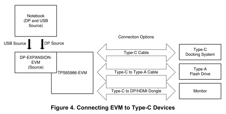

  • Hi Craig,
    Sorry about the repeated picture.
    For the DP function, try to use the connection topology in figure 4 of the DP-EXPANSION-EVM User Guide (look below).

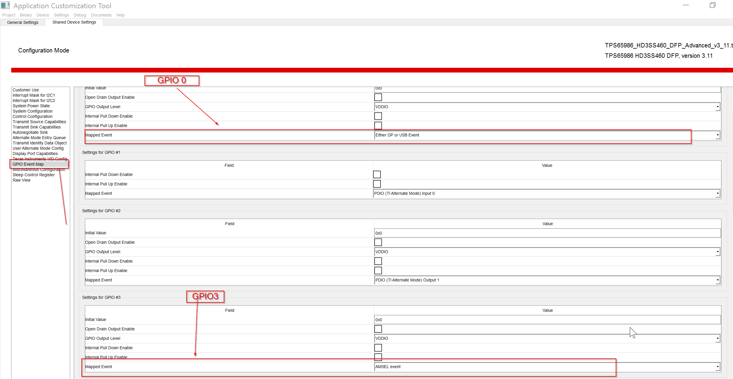

    The GPIO DP event mapping might be incorrect. Could you make sure that the setting of GPIO0 is mapped to “Either DP or USB Event”, and GPIO3 to “AMSEL event”.
    Also, you should make sure that the Display Port Config matches the screenshot below.
    FYI, the DP expansion has a passive HS mux, if the cable is too long, it may have signal integrity issues. Thank you for using our parts in your design.
