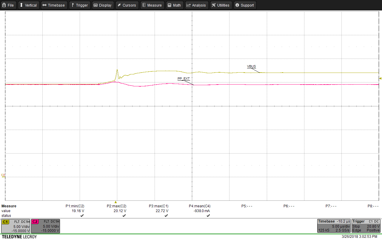

    This is a good question. I went ahead and tested this on one of our EVM boards. The response time for the OVP seems to be within nanoseconds.
    Here is my test setup:
    I set the OVP trip point to around 21.44V on VBUS in GUI for TPS65982. I went ahead and put a 22V power supply on VBUS on the source board.
    The test result is shown below: we can see when VBUS hits 21.4V, the switch for PP_EXT shut off quickly very fast. the respond time is short and could be within nanoseconds. The timescale below is a 5us window.

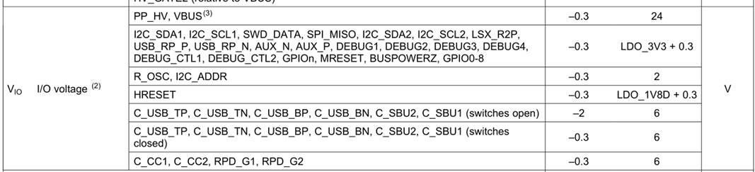

    If you would like to test the OVP, I recommend to never exceed the 24V listed in absolute maximum ratings; otherwise it may break the TPS65982EVM.
