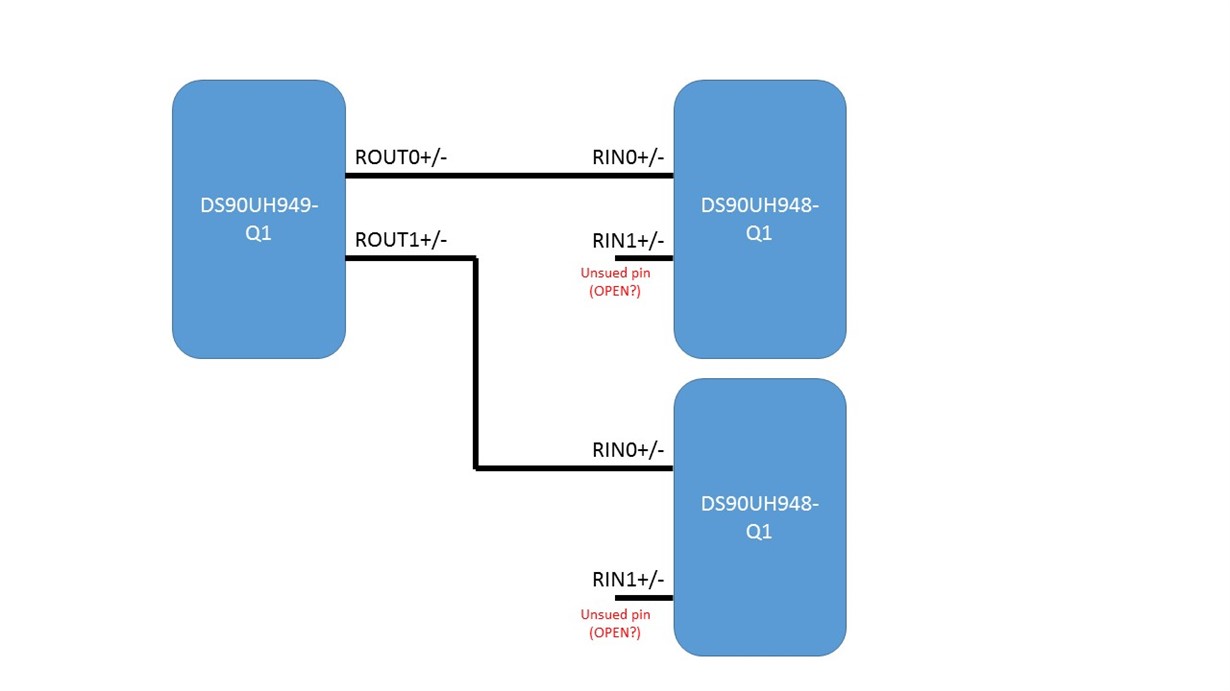

Part Number: DS90UH948-Q1
Dear support team;
Our customer wants the following connection.
Can we use this connection?
And,how should unused pins be?

Hello Masaaki-san,
Which exactly unused pins do you mean? If you mean RIN1 +/- then yes, you can leave them open.
If everything is connected correctly and 5V is also becomes available from the source, then yes HPD will become high.
