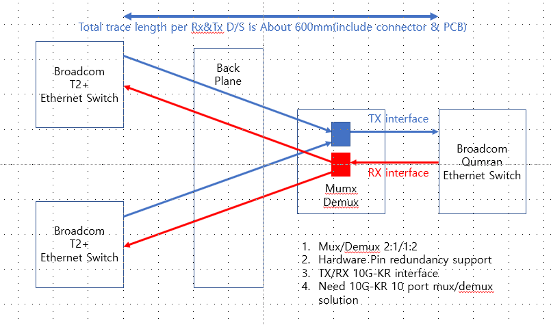

We consider TI's DS100MB203 MUX for below structure, and wonder whether we don't need any additional retimer or repeater when using DS100MB203.
If yes, please recommend a better product among DS100MB203 and DS125MB203.
(at TI website, the only difference is Peripheral I/O and could you also explain about this function if possible?)
If no, please recommend a suitable TI repeater or retimer device can be used with DS100MB203.
