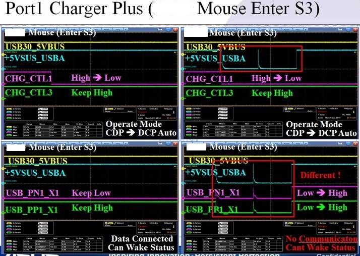

Hi expert,
My customer is facing an issue which is related to wake up event of TPS2544. Please kindly see below waveform for successfully wake-up(left)/fail wake-up(right) event. We used the same mouse and PC to test. For the failure wake-up event, VBUS drops and D+ drop. And D+/D- will keep both high so that host cannot know that device is plugged in.
Could you kindly help to verify why this event would be like this? Thanks a lot!!

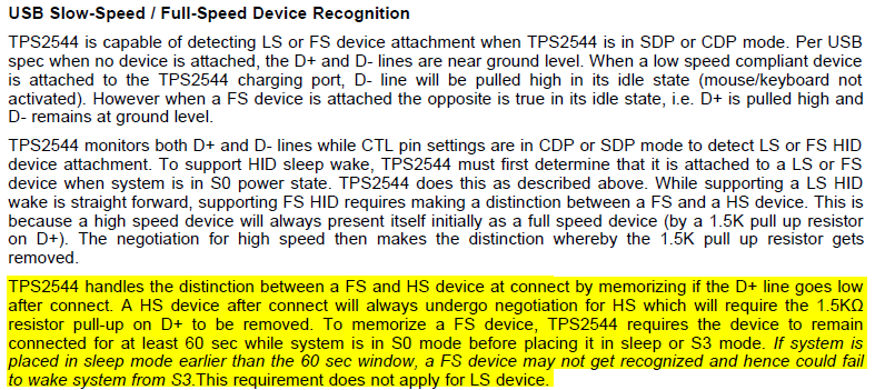

  • Ann,
    Since the mouse and PC are the same for both tests, is there a difference in the amount of time that you let the mouse be connected to the system before you enter sleep mode. There is a minimum amount of time for the system to remain in S0 mode before you enter S3 mode, or there could be issues and the device could fail to wake. Is found on page 21 of the TPS2544 datasheet.
    Would you be able to run the same tests that you did before, but have the time connected before going sleep remain constant throughout each test? See if that fixes this issue.

    Fail case:
    Sleep(S0 to S3) --> mouse cannot wake up system so we use keyboard(on laptop) to wake up(from S3 to S0)
    Pass case:
    After fail case->Restart laptop(reboot, from S0 to S5 to S0)-->Sleep(S0 to S3)-->mouse can wake up system (from S3 to S0)
    Please be noted that we tested by the same mouse and time device stays in S0 is the same(<60s). We are wondering why we don't have "60 seconds limitation" after system reboot?
    In my opinion, if this limitation is due to TPS2544, it should be the same(cannot wake up system by mouse in two cases) since we will always have this limitation and would not be difference before and after reboot.

  • Hi Ann,
    1. TPS2544 supports low speed and full speed devices wake-up from s3 to s0.
    2. Low speed and full speed devices must stay 60 seconds in CDP mode before switching to DCP_Auto mode.
    3. regarding to fail case, you said both D+ and D- keep high, it should be DCP_Auto mode.
    to solve this issue, please make sure the device will stay at lease 60 seconds in CDP mode (S0) before switching to DCP_Auto mode (S3).
