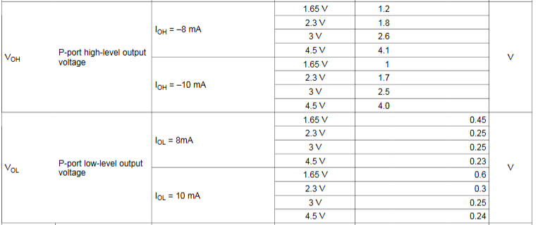

  • Hey Johnny,
    The port outputs rise/fall times are dictated by the capacitance on the bus.
    Lets look at figure 19 to get a better understanding of how the rise and fall times can be estimated. We can see two FETs which control the output portion of the device (Q1 and Q2). If the Q1 FET turns it, it pulls the signal high. If Q2 turns on, it pulls the signal low. Now we will have some amount of capacitance on the Pxx port pin so what we will see is an RC. C is the parasitic capacitance while R is Ron of the FET.
    Below is taken from 6.4 Electrical Characteristics. We can use the VoH/VoL and the IoH/IoL to estimate the Ron when the FET conducts.
    Example1: Lets say VccP is 3V and we see the device sources 8mA. Then Ron=(Vccp-Voh)/I or (3-2.6)/8m = 50 ohms
    Example2: Lets say VccP is 3V and we see the device sinks 8mA. Then Ron=(VoL-GND)/I or (0.25)/8m = 31.25 ohms
    We now know the Ron for pull up and pull down.
    Assume parasitic capacitance is 10pF (8.5 max due to our device and lets say 1.5pF from board).
    I will make 2 assumptions:
    1) first the device's port pin is connected to a high impedance pin/device
    2) if we calculate the rising time then the signal was previous low (GND) and if we calculate the fall time then the signal was previously high (VccP).

    I hope this answers your question,
