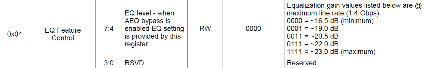

Dear Sir:
As I know 914 EQ gain values is 23 dB at 1.4Gbps as below picture , How about DS90UB964-Q1? It can support 15M single-ended Coaxial cable ?
