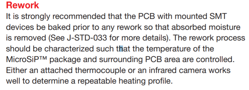

Dear Sir:
Due to we want to rework solder balling for TLK10232. Does TI have rework document for TLK10232 such as below example?
http://www.ti.com/lit/ug/slib006/slib006.pdf
Best Regard
Jason
