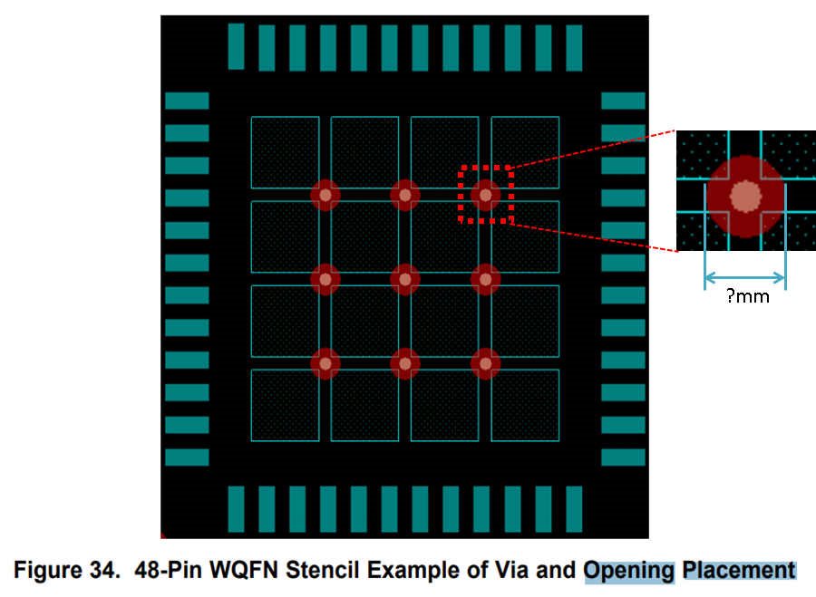

Could you tell me the following opening placement size?

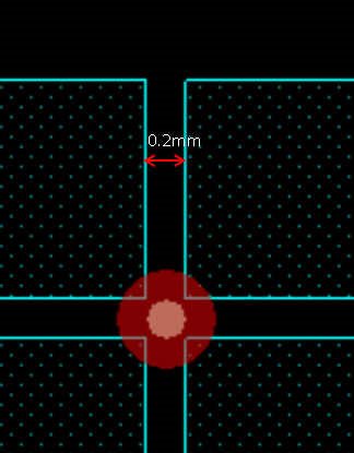

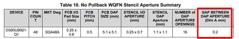

>The packaging diagram in this datasheet needs to be updated, a request has been submitted for this change.
Does it mean that the packaging diagram is wrong?
If yes, which part is wrong on the diagram?

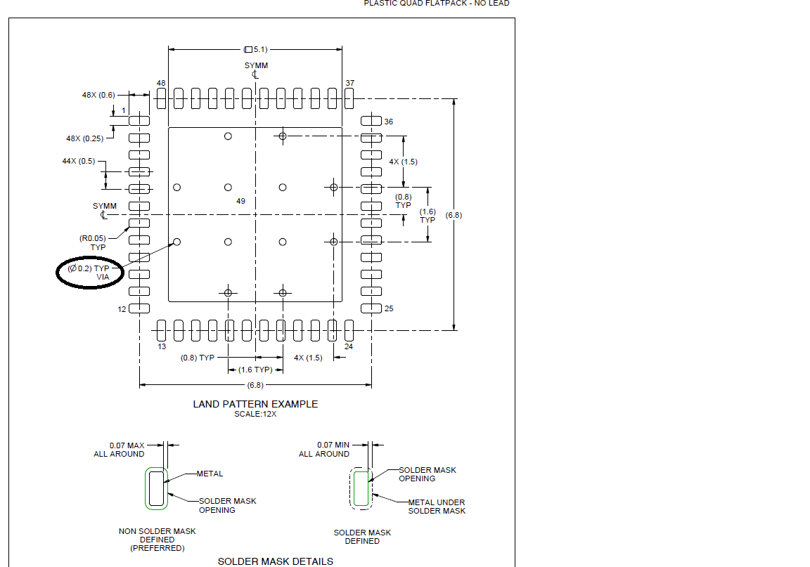

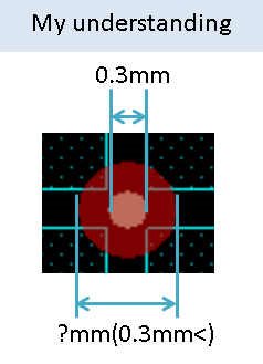

According to below thread and the picture, I'm understanding that recommended via size is 0.3mm.
So I'm thinking that the red circle should be over 0.3mm as below.
Probably, I'm misunderstanding something.
Could you revise and show the correct picture of size?
