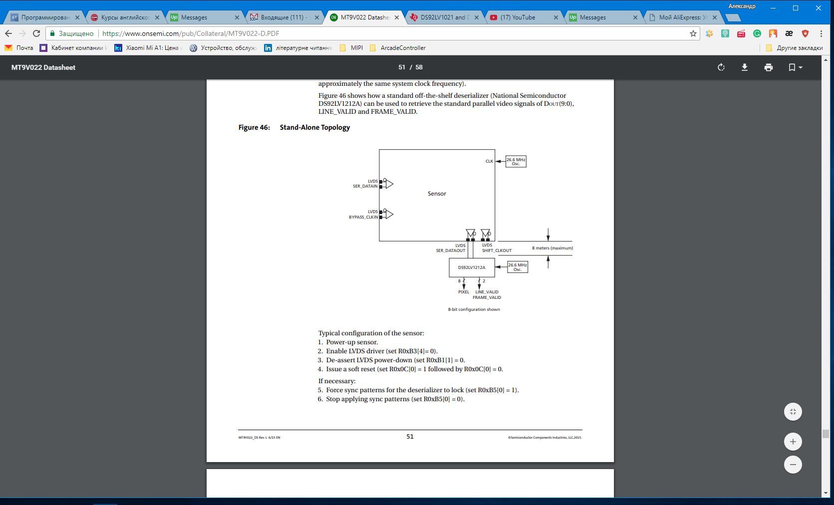

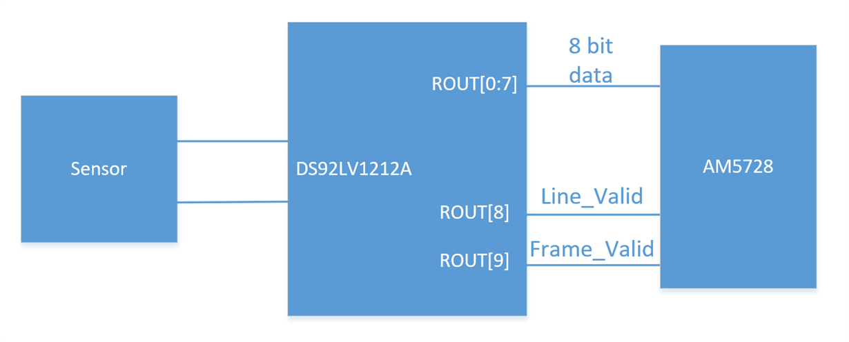

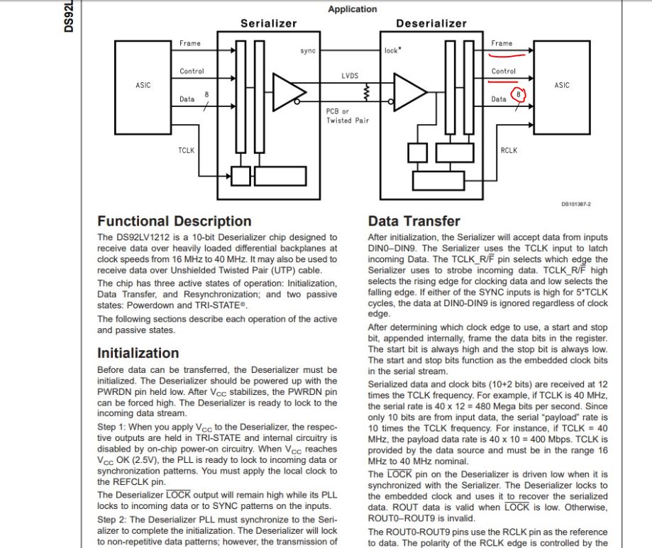

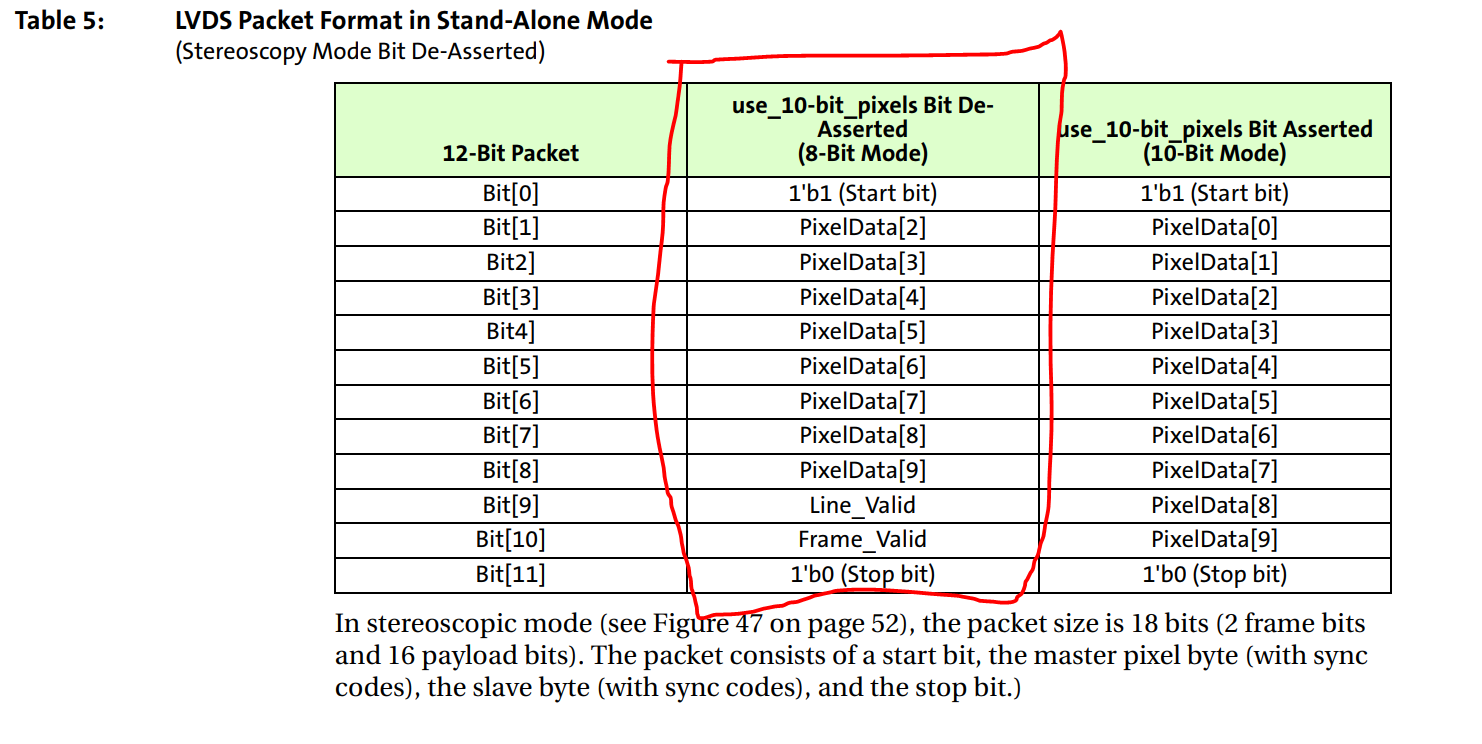

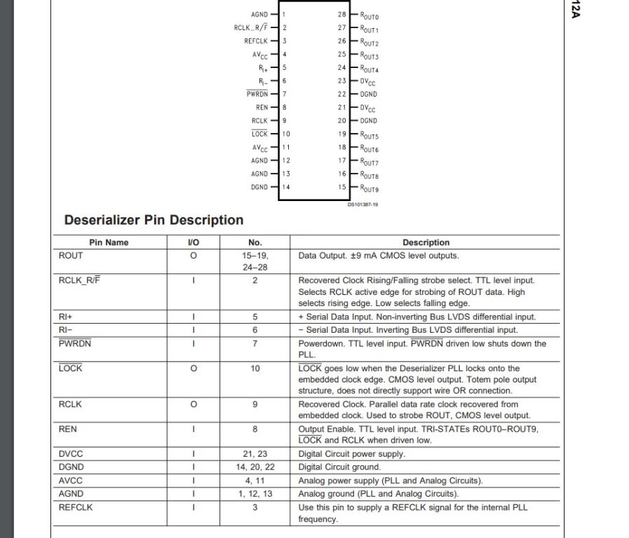

Hello everyone, I have a problem.  I want to connect DS92LV1212A (parallel interface) to AM5728 VIP interface. I will use Beaglebone X15, I make a board for connecting CMOS sensor  MT9V022 (www.onsemi.com/.../MT9V022-D.PDF) In datasheet provided application when for connections uses next signals frame, control, and 8bit data bus,  I want to connect it to vsync , hsynk and 8bit bus VIP interface AM5728 CPU.  But in pinout diagram, I see  10bit data bus and did not find frame and control pins.  Can any help me with it?  How I need connect it properly?
